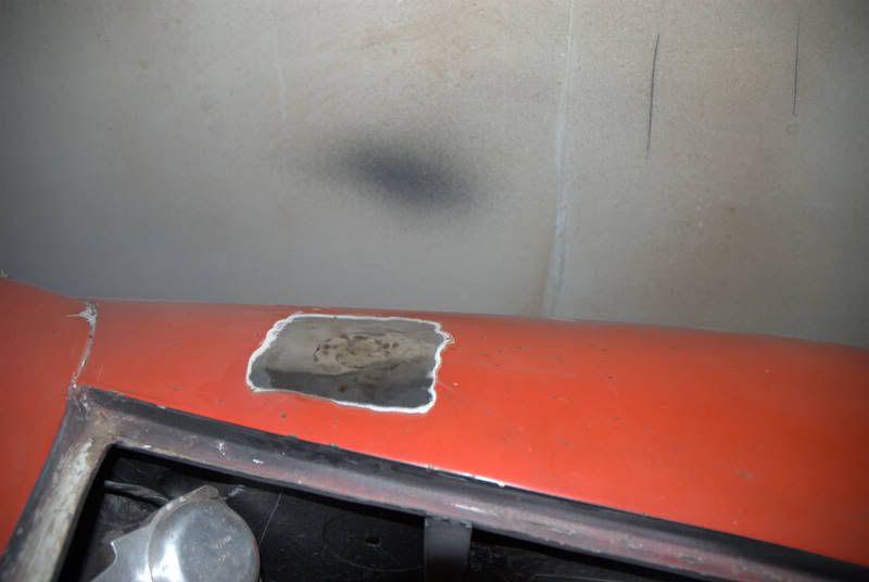

You can see the square holes in this pic that a PO had put in for a wing mirror.
and in this one the large rectangular hole they had made for the aerial on the other side
Here is the mirror holes filled with small pieces cut from an old battery box, welded in and ground back.
same treatment for the aerial hole
This was my first ever attempt at welding a panel, so i was pretty happy.
cheers
michael
cheers
michael
I did mine too, it's not that difficult with a good mig welder, just work use a quick feed rate and a low power setting.
