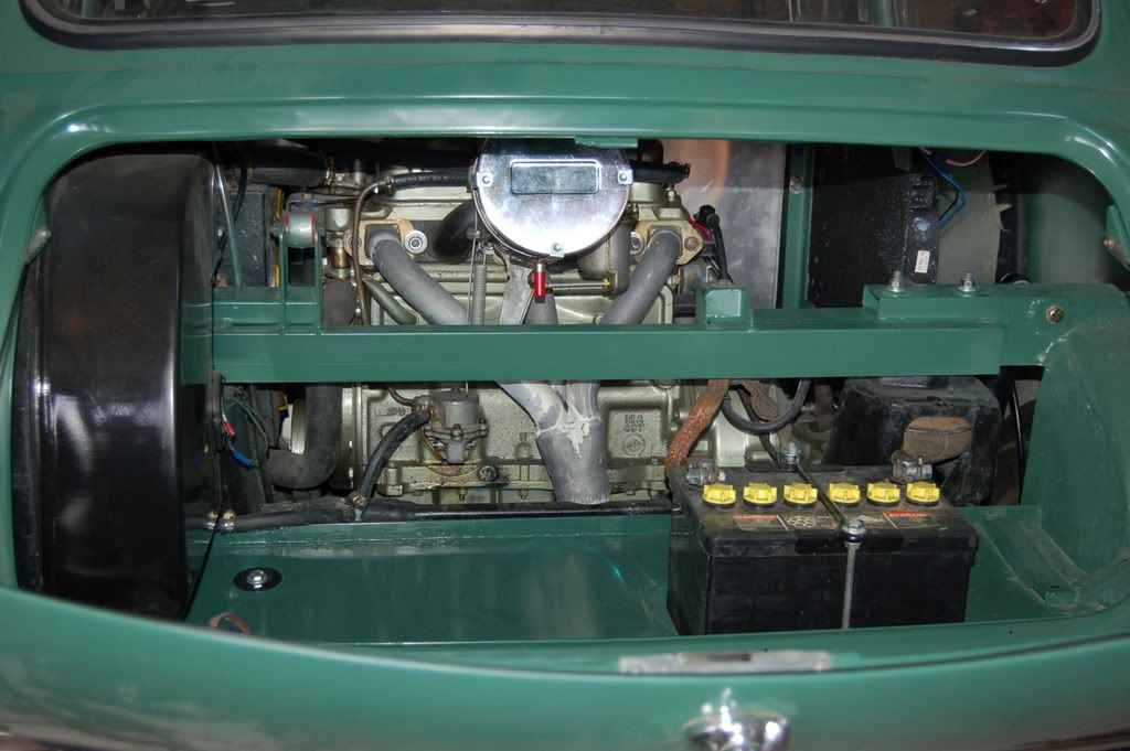

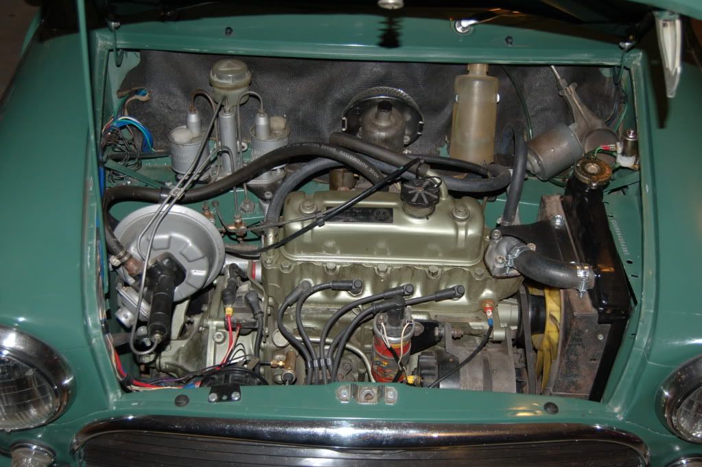

I was looking at fitting a second radiator in the heater system to assist with cooling.
This is in a round nose with a brake booster.
I assume it is a matter of finding the right heater core to do the job.
What is the best heater core, or otherwise to make for a tidy installation?
It needs to go under the bonnet in the picture, preferably with ½ inch outlets.
Or should the outlets be increased to make for better water flow and something easier to find?
I can change the booster to a VH44, and relocate the horn for more room.
Any ideas, photos, etc?

This is to assist get some of the heat out of the boot.
No problem with the current 1100 engines, but I am concerned if I go down the big block path with some HP.

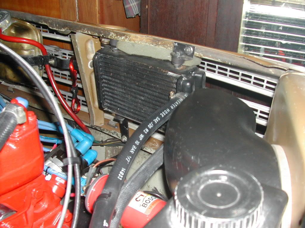

May as well be me then... I fitted this extra little radiator to my LS..
No, it didn't overheat in the first place but this is just an extra bit of cooling help and as everyone knows, every little bit helps....

That looks a good installation.
What is the radiator out off?
Can you supply the dimensions –width, breadth and height?
PostPosted: Sun Mar 15, 2009 10:29 am
Posts: 1607
Location: Townsville, Qld
Indigo.. I bought it from a local radiator repairer and I think the radiator was from a motorbike.
The dimensions are:
H = 190mm .. W = 160mm .. B = 50mm
