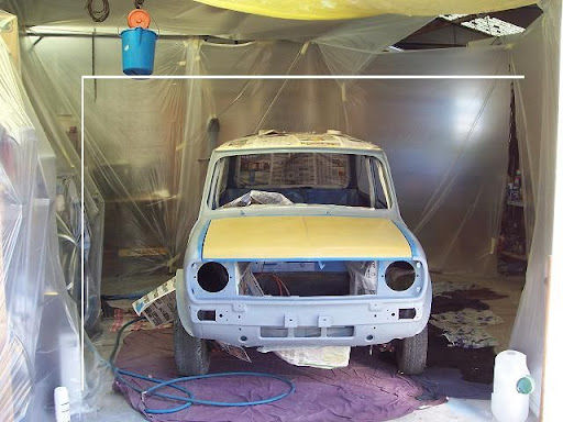

i like the idea of how u put extra coats on your edges and seams Tombo Very good idea. Thanks. Im still waiting to throw my second full coast on the car bonnet and bootlid first coat on the doors and number plate flap. edit forgot to add im waiting for good weather days and not rainy days. do u think it is a good idea if in throwing paint on When it is a rainy or Hazey rain speckle day? im painting under the house no booth setup.

Regularily drain your compressor and since you cant avoid humidity (unless you have a de-humidifier) try to avoid painting when water is falling from the sky.
My mates charger has tiny water pimples in the paint from moisture.
My booth was just drop sheets taped up in the shed :oops:
Turned out good though, maybe 4-5 bits of dust landed on it.
