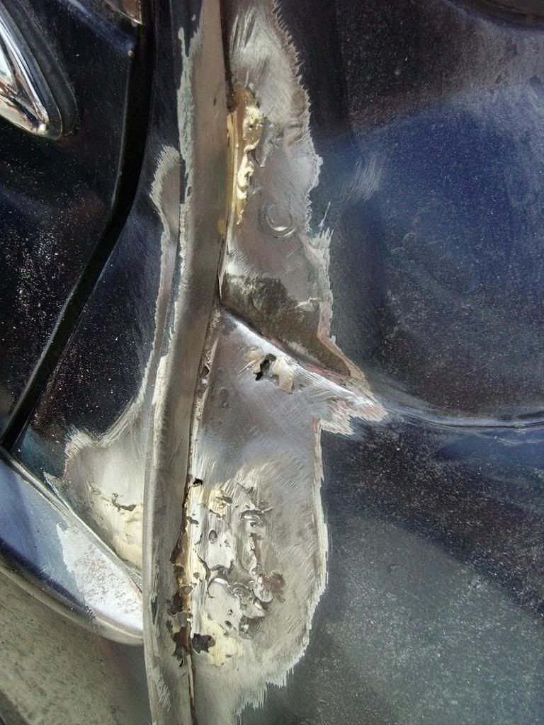

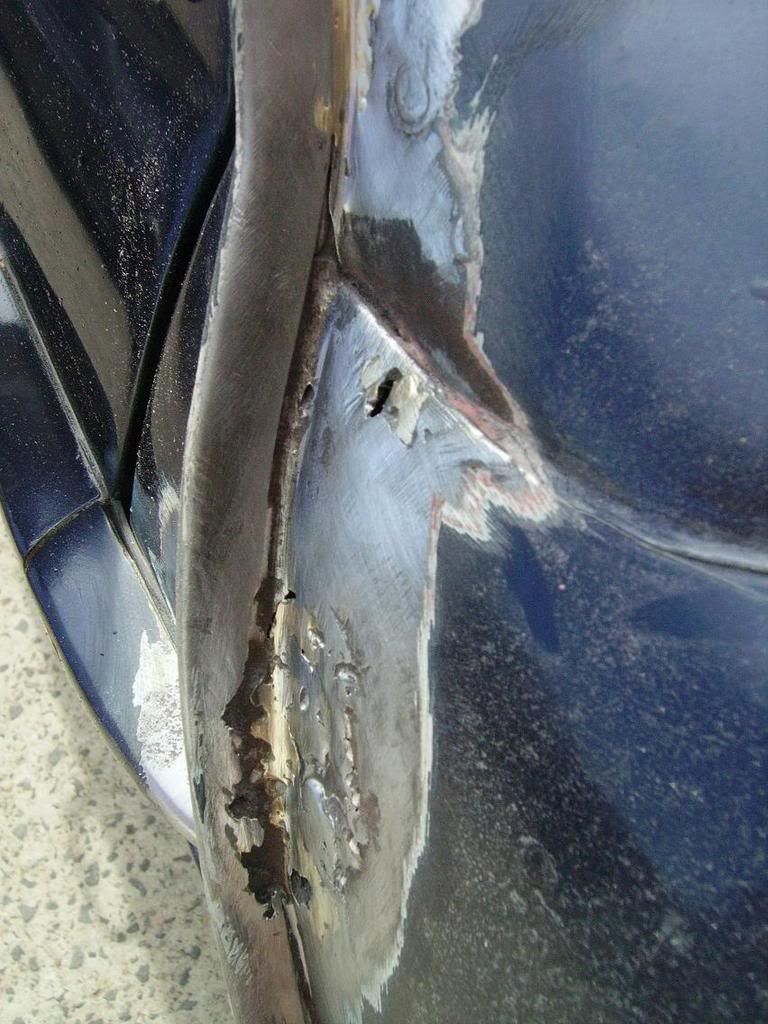

I have seen some bubbles comming up here and their so to is got the screw driver out
Result
Not to bad considering I have seen a lot worse.
I't looks like the PO has done some draising before they did the crap paint job.
I'm expecting this to be fixed with just some wels and rubbing back

Jim, cut it out until you get clean metal all round, then weld a patch in. Otherwise, it'll just keep coming back. :evil:
Trust me- I owned 2 Valiants... :lol:

like others have said, if that rust is there... there is sure to be more behind it. check out surrounding areas, spray fish oil in there and weld it back up if the other metalwork is ok.

Ohh Gaf you have opened a box of worms...you have to grind all the bubbles of and then post pcture of your holey morris....or half morris half air.. :roll:

Rust is heavier than metal- cut it all out and you'll go fasterrrrrrrr.. 8)

The rust area's that I know of are slowley progressing and the further I look i see a few more bubb;;es as the PO didn't do the rite thing as well as doing a bad (thin) paint job. Spring is around the corner and so is Summer so its perfect time to start.

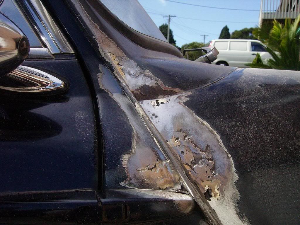

No crack thier but here is a few more shots of the PO's work
I think I now call Morris "Braisen"
