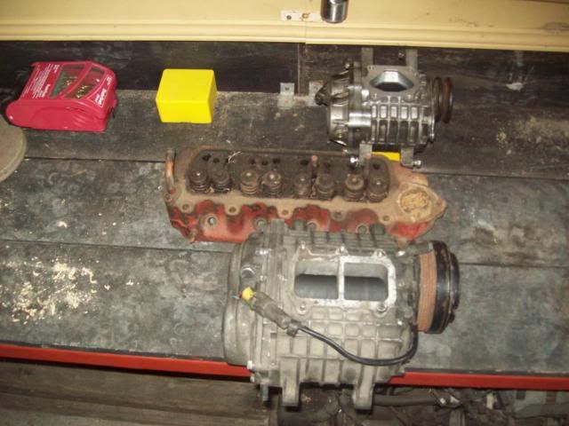

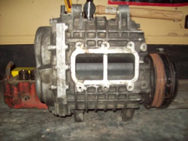

I picked it up the other day and I'm trying to figure out what it's originally off, what size engine and how many cc's of air it pumps per rev?

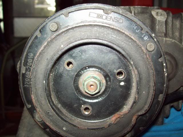

So far I've only found the word DENSO http://www.denso.com.au/ and the number 17068-70010, but nothing comes up in google :? .
Compared with a mini head and an AMR300 supercharger;
If you have any idea what it is let me know please.

SC14
Sc12
14
I have better pic's somethwhere
Sc14 have a Dipstick

It' doesn't have a dip stick and it has an electronic clutch.

Its a SC14. some models had a little dipstick that was part of the filler plug. The elect clutch was fitted std, but only to make them more drive able.
The rotors are teflon type plastic and do not like hich boost pressure or very high rpm. What size eng are you going to put it on and are you going to suck or blow thru carb or injection
