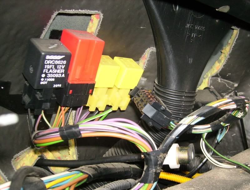

HELP please!!!
have figured out we need a new flasher can/unit thingo.
but where the heck is it? I have the CD rom for Minis but can't find it in there....
Mine is a 1997 Rover Mini. Some diagrams look like it is behind the dash??
Any help would be great.

PostPosted: Fri May 01, 2009 6:48 pm
Posts: 7339
Have a look here
Original Rover Dealer Workshop and other manuals as supplied to the dealership on CD or is that the one you have?
http://mini.nicehelp.co.uk/
Page 1 Description and Operation - Electrical section Workshop Manual
Looks like top centre of firewall under bonnet
David L
PostPosted: Fri May 01, 2009 6:51 pm
When you pull the dashboard off, this is what's behind it:
