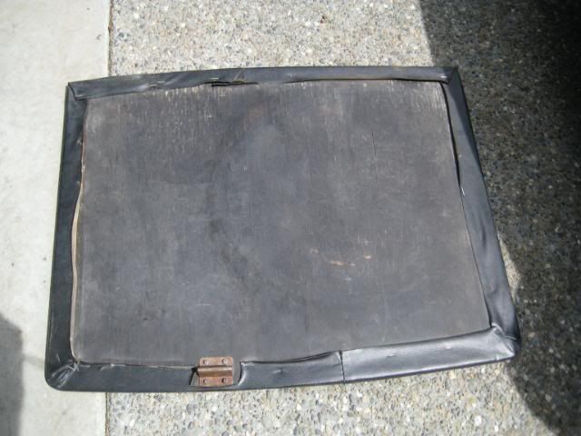

My '70 cooper S is ready to go to its new home in Canada, and I'm trying to decide which spare belongs to it and which one belongs to my '66 S; and also whether the one boot board I have is for it, or for my '66 S.
Here are pictures of the spares:
And here are pictures of the boot board:

Boot board would be for the 70 as all Mk 2 were black. Mk1 had same colour as interior vinyl.......I am pretty sure, well fairly sure.....
Cooper S Mk2
Cooper S Mk1

Ok, then LP882 is the 3.5" standard Cooper S rim and the one that will allow the bootboard to fit properly on a English S. Does the same apply to Aussie S's?
Regards
Al
PostPosted: Mon May 11, 2009 11:05 am
Posts: 39757
Regards
Al
We never ever got the 3.5" S wheels in cars here, they came with 5x 4.5" S ones.
