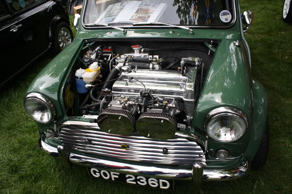

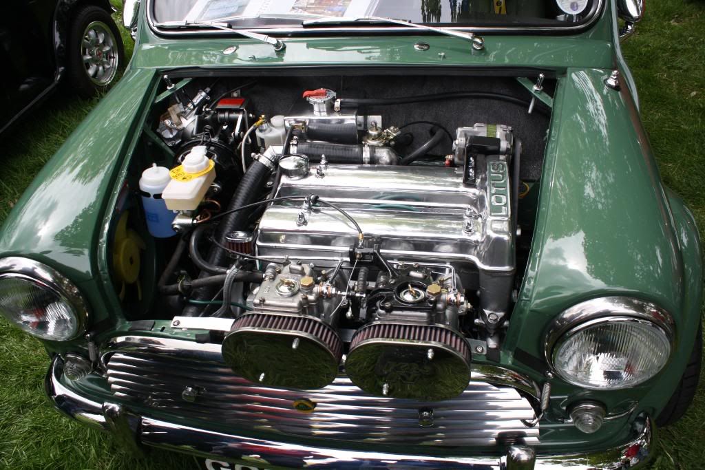

We have our conversions down here but this is the first time I have see a Lotus engine in a Mini :shock: Just amazing.

Can't quite see enough to see if it's on the mini gearbox or not , sure looks good though .

I'm thinking on the lines of a lotus head on a ford engine (cortina or escort) onto a mini gearbox with the older style crank adapter the pom's were famous for . Could be the top of the mini clutch housing peeking through at the rear of the engine ...

And the best part ist: it's on a mini(-ish) gearbox :roll: It was for sale some years ago somewhere, can't remember.
They were made by 'Manx', for Ford 'Kent' engines. But of course Kent based Lotus engines fit aswell. But I think both engines needed a special crank or crank tail adapter to take the Mini(?) flywheel:

Ooh that's nice , most of them I've seen photo's of were cruder versions with heavy alloy plate bolted to a standard gearbox rather than a recast gearbox .
