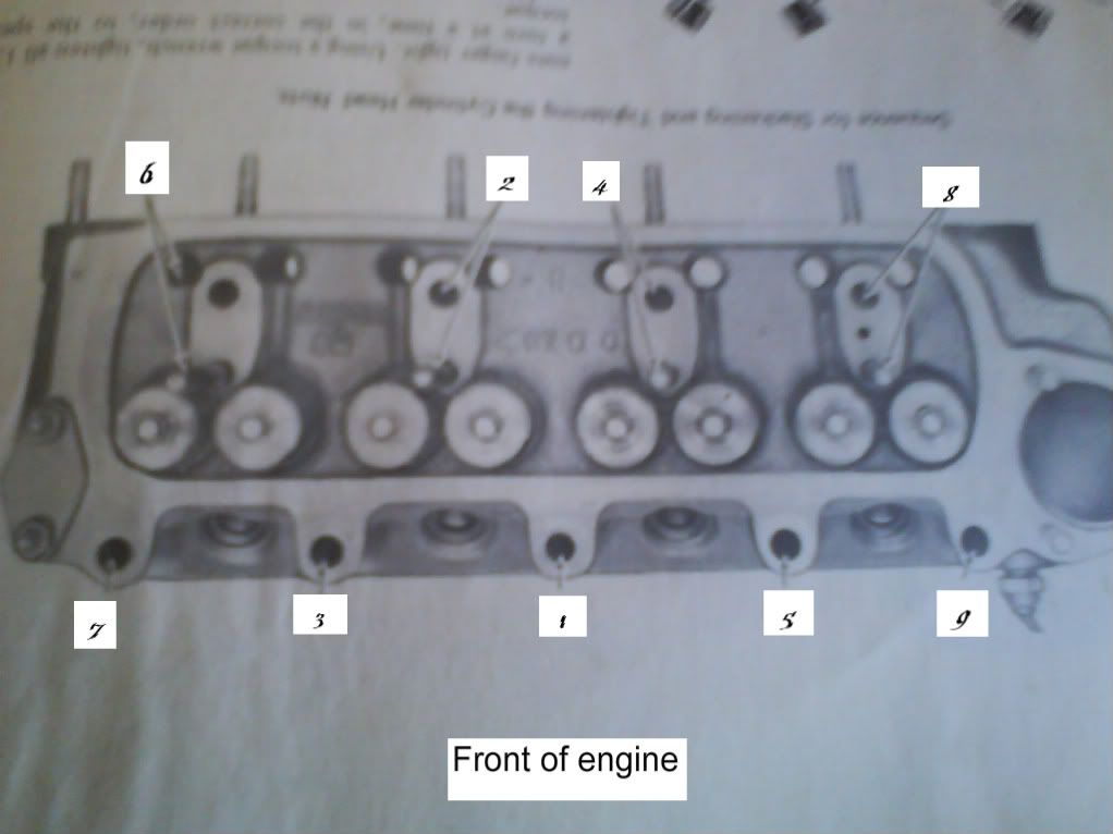

PostPosted: Sat May 09, 2009 12:35 am
It's not hard at all, just a basic socket set would do and borrow a torque wrench to tighten it back up.
Someone can post a scanned pick of the correct way to retorque the head.
PostPosted: Sat May 09, 2009 3:28 am
Milatsmadmini
Posts: 6287
40pounds torque....
