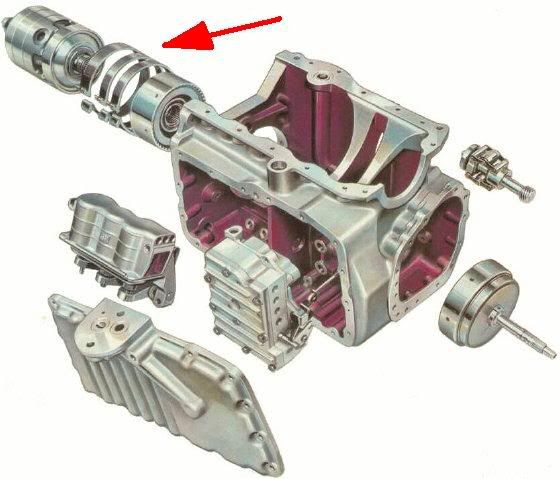

Just wondering if someone would be able to tell me what the possible problems with a mini auto (rover) is if all forward gears drive fine, but reverse has no drive. If the front wheels are off the ground the wheels drive in reverse and speed up with revs, but with the car on the ground the car doesnt move. The best way to describe it is a manual clutch slipping completely.
So list away possible faults please.
Someone also suggested replacing the valve type thing on the drivers side of the box. Would this achieve anything?

I'm going to guess that the reverse band is slipping.
If it is, engine comes out, front cover off the gearbox and ajust it.

Slip in reverse = items 4, 5 or 6. (from auto manual)
4: reverse band adjustment, or reverse servo feed pipe seals.
5: clean valve block, regulator valve or reverse booster piston faulty.
6: check top & reverse clutch booster piston or shutoff valve.
R band can be adjusted in car, if lining not worn out.
There IS room to get the cover off.

The bands are the red arrowed douverlakis I believe.
