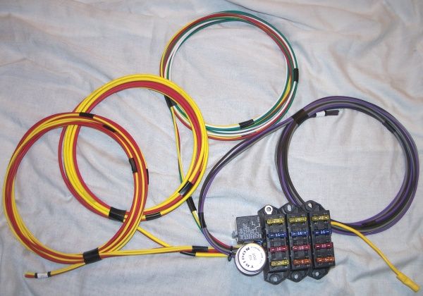

While I was at it I'd thought I'd try something else that was in my head for the fuse box. This is just a practic with some spare black I had. the idea is for Fuel Pump, Radio, Blinker Can, Brakeswitch & Heater (All Green) to have thier own Fuse and the other side will be the same but the White Wires from the Coil & to IGN. A bit of fine tunning should see it nice and neat

PostPosted: Sat May 30, 2009 7:19 pm
Proto type 2
Its finished now but the camera doesn't like the light but you get the idea of how I got thier
last white Heat Shrink on and nice and tight should work nicely :wink:
