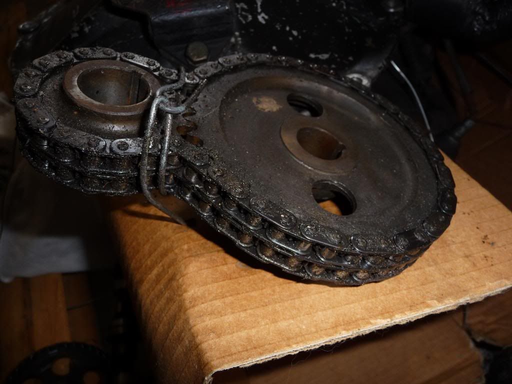

Should i be happy that i found a good double row timing chain??

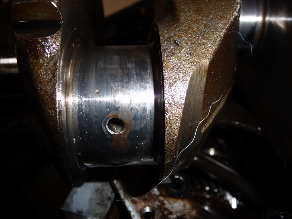

This is no-4 crank bearing, reckon i just caught it in time

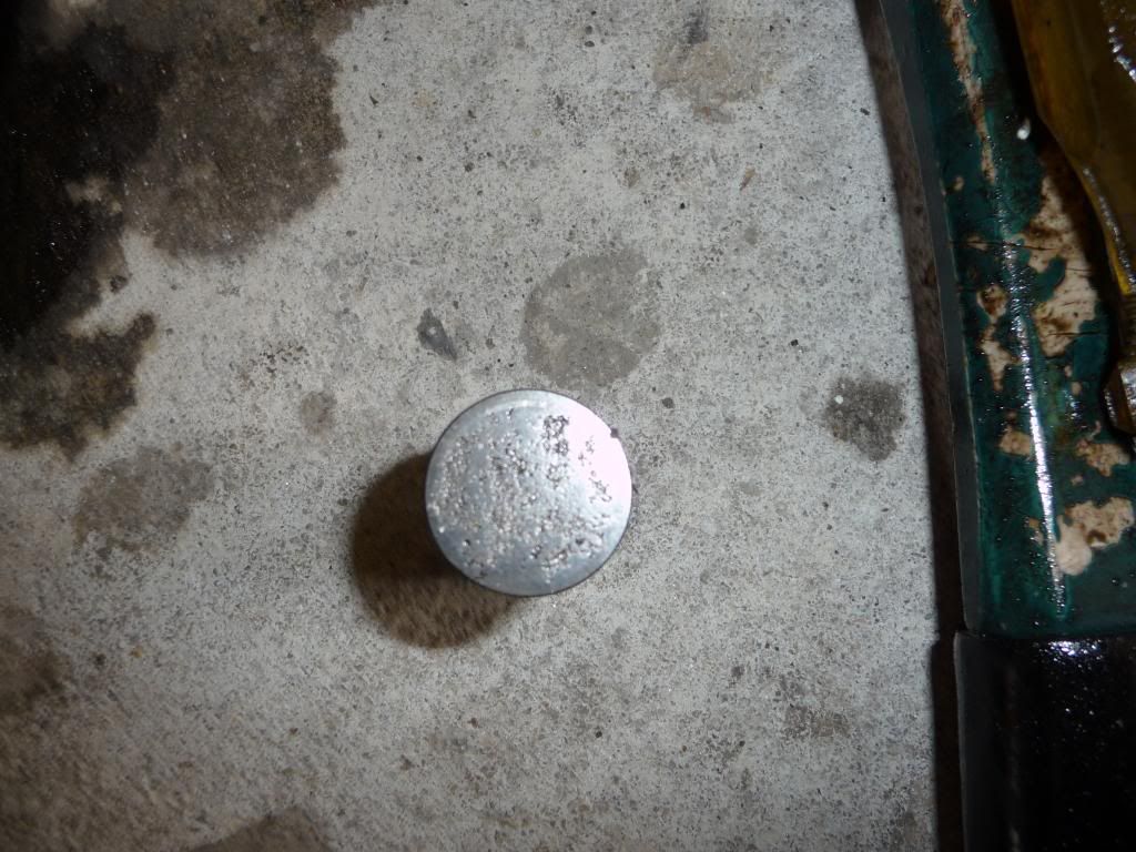

All the lifters are like this except 2 but the cam looks as new

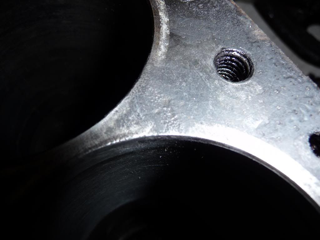

This is my biggest worry, cos she was sitting for so many years corrosion has eaten into the block face, Will a deck fix this?

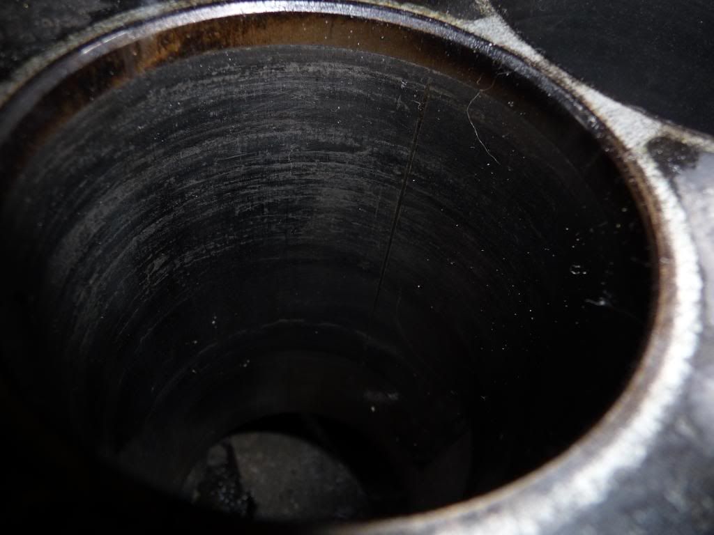

2& 3 bores are like this so i guess a rebore is in order, i gave no-2 a quick hone but corrosion marks are still there
Rusty crank journals. Dont you hate it when good things are neglected!!

Block will machine up good.
Just send the bits to a good re-con shop and it will come back all good, it's amazing what they can do.

cam bearings prob not too flash either.

Is this the LS Maxx ? If so be very clear with whoever decks the block that it is a matching number classic carand the engine number has to remain untouched while they skim the top of the block . It is possible to do and you should check with them if their machine can do it that way before letting them do the job .

Bit worried bout those funny looking cracks :roll:

Get that 1275LS crank crack tested before grinding. Many are cracked... :cry:

Make sure they keep that nice radius on the crank journals 8)
That would be cat hair, its everywhere here, even i get hairballs :shock:
Yes it is the LS Sports, thanx for that regarding the engine number, i never thought ov that. I will stress that point profusely

Block yep will need to be cleaned up to the next size (if not the followiing)to you will need new piston and rings. Check that the rods are the same weight and straight.
