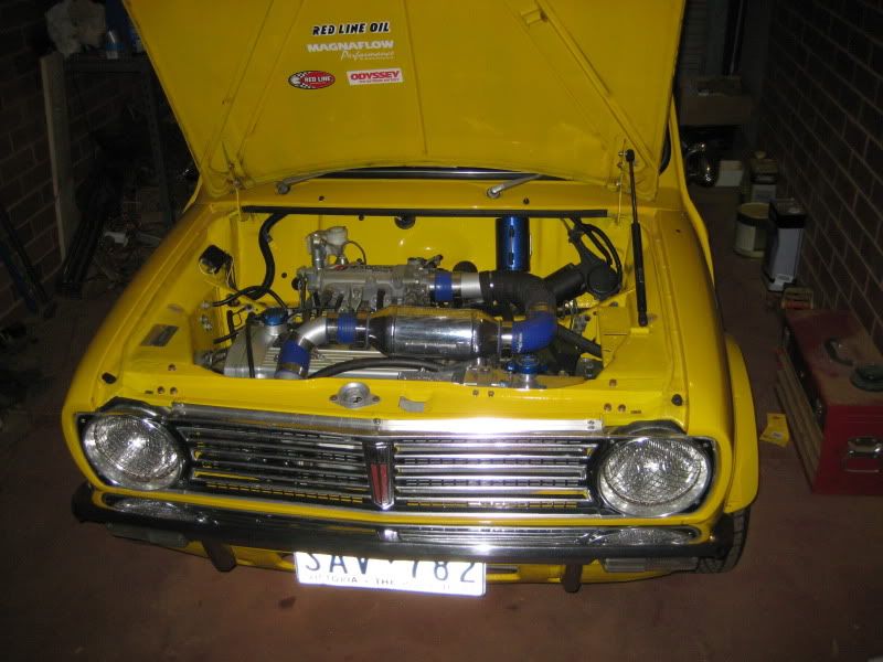

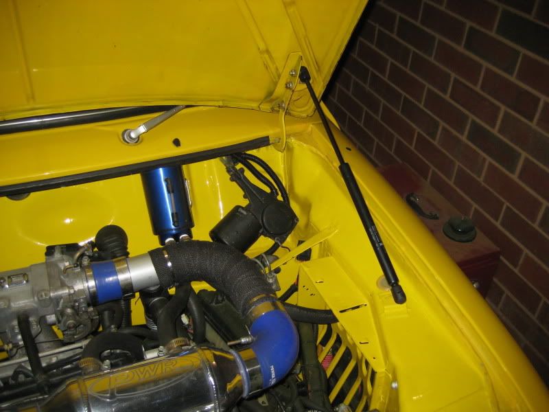

I've got one strut only on the passenger side. Its a Monroe Lift-O-Matic 5897MK 0130N. I'd say that it is 130N force from the part number.
It is the perfect force for how I have mine mounted, I think. It holds the bonnet up well at full open, but it will also hold the bonnet at different angles partially open. :wink:

not the best pics but it gives you a bit of an idea. I've mounted it through the hinge and into to the catch for the old bonnet stay. easy. :wink:

It will depend on the leverage it can apply. The closer to the pivot the more force is needed because there is a larger closing moment being applied. If the strut acts up near the opening of the bonnet (at the front) there is less closing moment & thus the amount of force in the strut can be less.

This is where i have put them on both of my clubbies. Never done a roundie.
The struts i've used have been weak 2nd hand ones from cars that have come through work.
I've only fitted them by the radiator and on one bonnet it broke the spot welds where the hinge bracket fixes to the rear edge of the bonnet.
On this example the strut is upside down. It's best to keep the fat end at the top when in the closed position, this lubricates the seal (one of mine got sticky from being the wrong way). Also, they work like a screen door strut, when fitted correctly (with the fat end at the top) it will slow down just before it reaches full extention, so it doesn't fly open and hurt the bonnet/hinges :wink:
