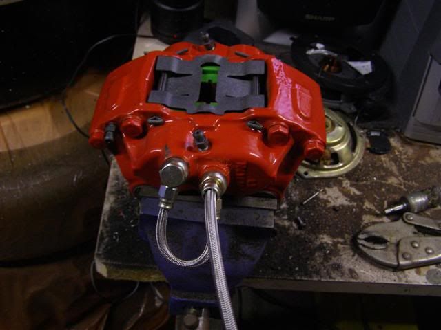

hi i have these metro turbo ap calipers on my car.
I too at first asked link automotive how the calipers were running both sides of the caliper when i was using only a single hose..
they modified the caliper..by drilling into the other cylinder..and puting a blank bolt into were the other hose would go..
ive since upgraded to the proper hose kit...but i ran a single line for over three years and had no problems.
brakes were always great...sometiimes too good...
photos will tell the story..
my gues is that they will work just the same as the old setup but at least this way they are back to the way they were intended to be..

hmmm questions..ill do the best i can.
my two calipers are a bit different...one runs a spacer and the other dosent...there both ap and the same size...was told some came with a spacer and some diddnt..so i gues ive got one of each...in the photos you can see one has spacer in the middle and one dosent....
i nerver ran a booster..theses brakes were allways great....yes ..you had too push the pedel to make them work...but not much effort.sometimes they worked too well so i had to be carefull when in the wet....as for brake master cylinder used...to be honest im not sure what type was on my last mini....it had a cycle cyliner on the top...plastic....

Posts: 1882
There a two types of 4 piston metro calliper, the early type had a spacer fitted when they went from solid to vented discs. The later type did away with the spacer & the 2 halves of the calliper are wider.
