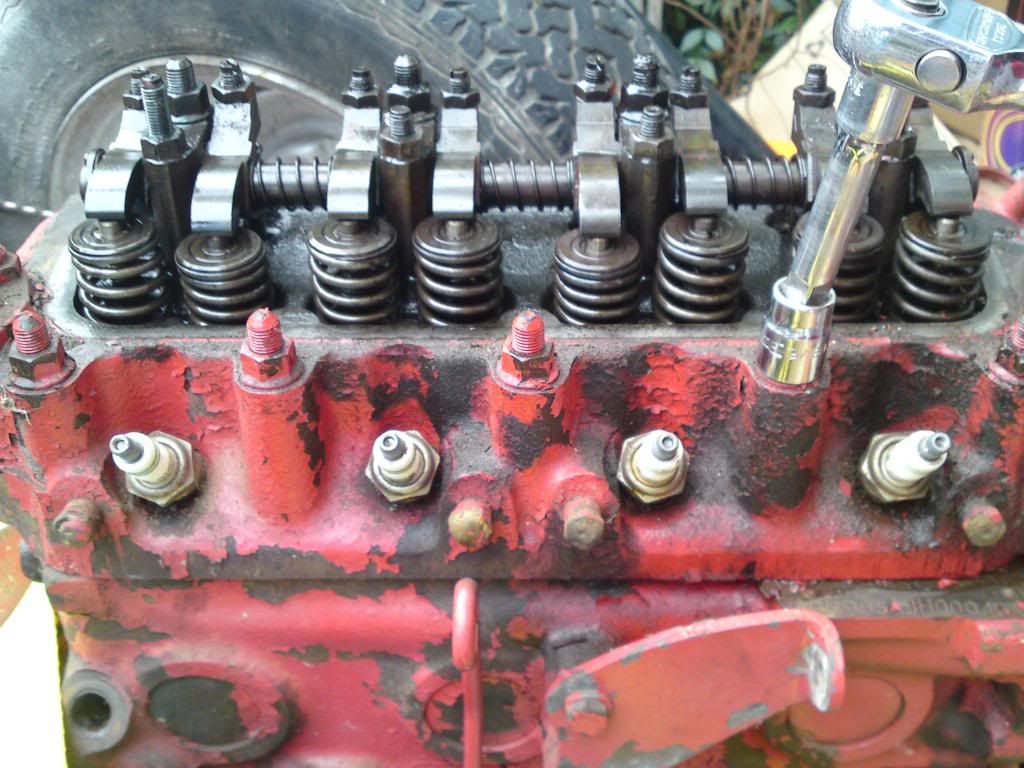

and what rockers are they?
Just scored this off an old friend who had it stored in his garage for a couple of years...
but what head is it? got a little bit of porting, 2 J7??? and 4 bolts along the front?
still trying to take the head off to check chambers... but the nuts are being a wee bit annoying (any help with that one too?)
PostPosted: Wed Dec 23, 2009 4:49 pm
Late model small bore Polution type head
nothing wonderful really
It`s just a late , tiny little port cyl head off a 998 designed to have all the anti polution type crap on it

What are the rockers on this head?

Matt, seeing as how there has been half a dozen posts here none of which are relevant to your question I'll say that it looks like a late model polution head,,, maybe A+... can't tell you anything else but maybe some one else will now that its back on track.
A+
PostPosted: Wed Dec 23, 2009 5:44 pm
Phat Kat wrote:
A+
They are the same rockers fitted to the polution motors in 77/78 in Australia.
So they may be fitted to A+ but they were fitted for a few years before that.
The head and the rockers look like late Aussie Mini 998.
As for GT Mowog....
PostPosted: Wed Dec 23, 2009 5:52 pm
Posts: 3135
So are these rockers superior than the pressed metal type and interchangeable with earlier motors?
PostPosted: Wed Dec 23, 2009 6:06 pm
The only way they are superior is that they were cheaper to make. :lol:
The general opinion is that they are not very good.
PostPosted: Wed Dec 23, 2009 6:20 pm
Posts: 39756
They are rubbish really, when they wear you cannot rebush them like all the others, as there ain't no bush! They are sintered (hot pressed iron powder) and run direct on the shaft.
I have one at work off a 1275 which wore so bad the rocker broke in 1/2 through the bottom. The shaft wasn't pretty, either. :lol:
