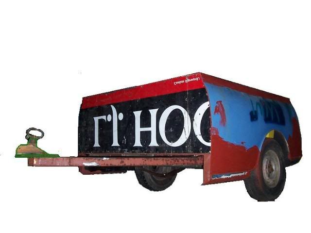

This is my panelvan trailer so far.
This is the build thread so far http://www.ausmini.com/forums/viewtopic ... ox+trailer their may be a link to other builds in that one.

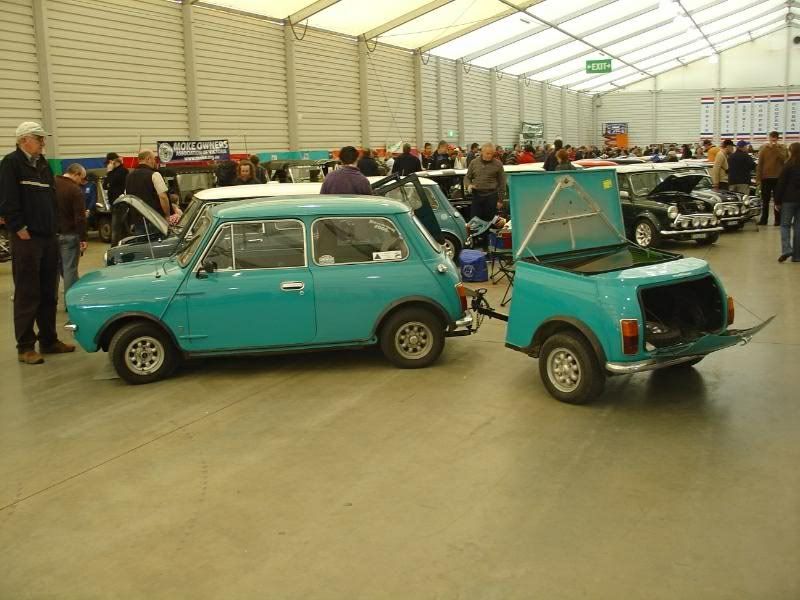

This one was at the 2008 Mini Show in Melbourne (and also Mini50Show I think).
