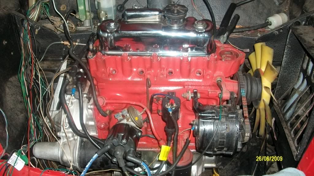

Hi , i can not get a spark on my 998. I have 12V going to the + on the coil. The - on the coil also reads 12V. It's a pulsar dizzy.
There is 12V getting through the primary coil lead to the distributor.
The rotor turns (i checked it with the cap off).
I even tried it without the leads on in case they were the problem (just put the multimeter inside where the lead goes to see if that gave a reading) but nothing.
Could i have put the dizzy cap on the wrong way? Would it matter if the timing isnt set or is out?
Are there another wires or is there anything ive missed? Every wire was disconnected in the engine bay when i bought this car but i have power to ignition, it's cranking, the coil and alt have power. So as far as i know i should be able to start it...
here's a pic!
http://i246.photobucket.com/albums/gg10 ... GP0615.jpg
If theres any guru's in perth who would like to have a look that'd be much appreciated!

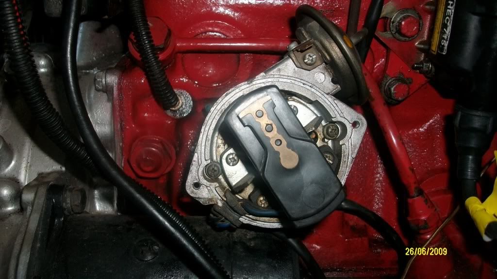

Did you check the cap and make sure the sprung electode that sits on the rotor top hasn't fallen out
Mini, its in my blood........
PostPosted: Fri Jul 23, 2010 6:25 pm
Posts: 211
Location: Perth
sprug electrode, wtf is that.
any place i can see a pic? lol

will do that now. here's the rotor button...
http://i246.photobucket.com/albums/gg10 ... GP0616.jpg
PostPosted: Fri Jul 23, 2010 6:47 pm
Posts: 211
Location: Perth
ok yeah ive got that thing, thanks mate
