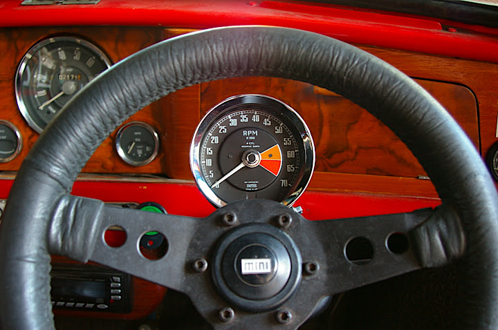

I have a 6.5 inch monster right in the middle of the dash, and a 5.5 inch speedo on the column.
:D
Later smiths stuff is dampened pretty well, it's mainly 60s and 70s stuff that isn't.

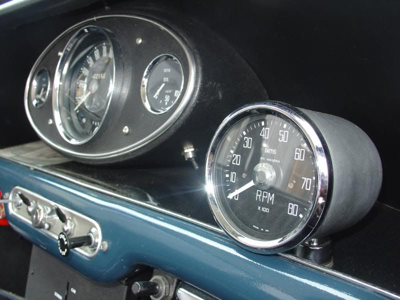

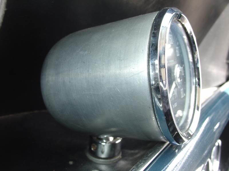

This is my set up
being an 850 i was trying to keep it all period looking

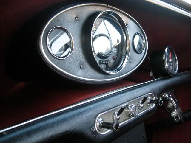

Have a newer Smiths Tacho (electronic I think), works well.
Mounted using the two bolts that hold the column bracket
Used a flat piece of Aluminium, drilled two holes to align with the two thumbscrew bolts normally used for the U-bracket, cut a hole for the socket to fit thru.
Painted the bracket and the back or the tacho matt black to help hide it.
Bottom of the tacho rests on the edge of the dash shelf so it doesn't shake around.
Depending if you have a steering wheel drop bracket or your seating position it might be slightly out of view so test position first.
Hard to see in this pic, tell me if you want better pics.

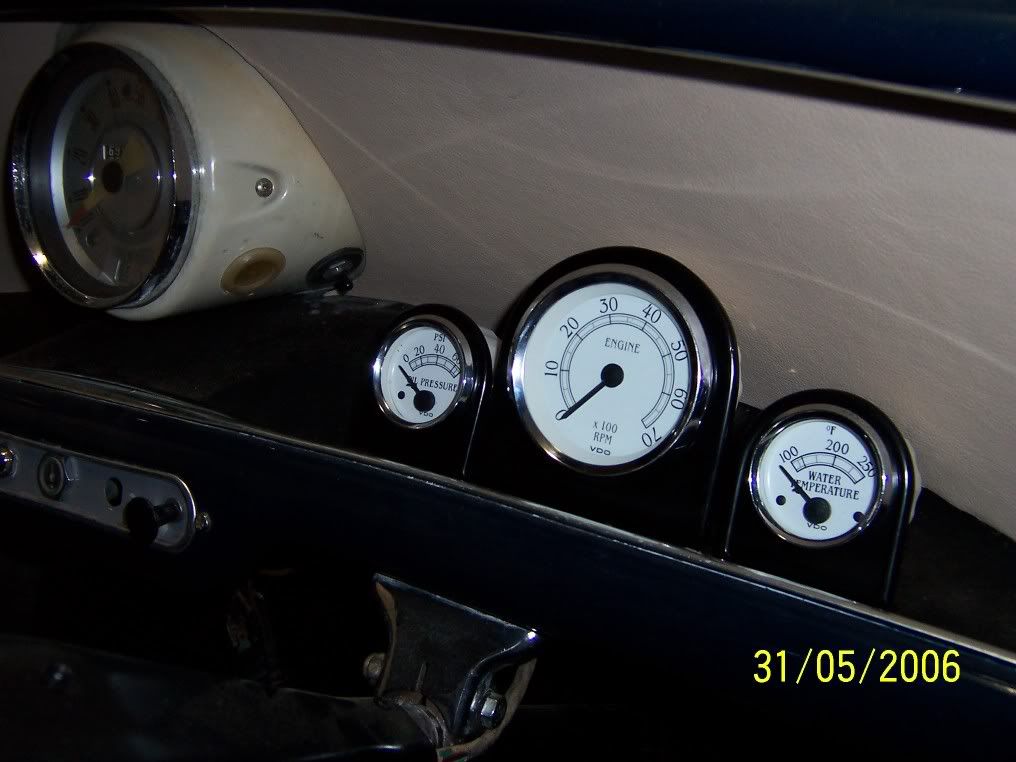

PostPosted: Wed Sep 01, 2010 7:56 pm
VDO are good stuff. :wink:

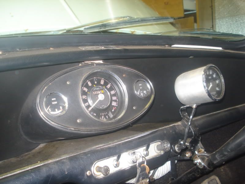

Heres mine,
Smiths Gauge. It wobbles a bit when accelerating but I like the classic look. Connected via a vertical mount that is covered by a circular bit of rubber which also hides the cables.
