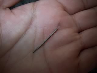

I was changing my oil this morning and this small spring was on the sump plug. Its around 2cm in length. Any ideas about what it is and if its anything bad?
Cheers Matt

Hmmm... looks like part of the spring that keeps tension on the primary gear seal :?
Does the clutch judder at all?
cheers
Jacob

I think its the spring found inside one of the crank oil seals, they wind around inside the seals to improve sealing.
Do you have any oil leaks... yes i know all minis leak oil but can you pin point a leak from the radiator end or clutch end, if not you may have one soon.
Im sure someone else may know more than me tho

Nope don't have any oil leaks or clutch judder, but recently i noticed that the clutch isn't as hard as before, i don't need as much force to push it down, and it engages much sooner in the pedal.
Hope its nothing to major :? :(

I heard there have been probs lately overseas with these clutch seals losing their springs on assembly.

Just went and had a look at the clutch split pin and not oil is dripping from there :?
Hmmm...china i guess :evil: :evil:

Shows those little magnets work.
Definately a spring from a seal but what one is anyones guess.

it could also be from the selector seal on a remote (two rods to gearchange box) although it looks too long. They always leak anyway. :D :D
if its from the primary gear seal, wonder if the rest is in the seal or been ground up by the gears.
only other place i can think of is the two seals on the diff side caps.

If its the primary gear seal wouldn't oil be leaking from the split pin under the clutch housing?
PostPosted: Fri Oct 01, 2010 8:54 am
Not until the rubber itself goes hard.
should be allright for a while yet.
