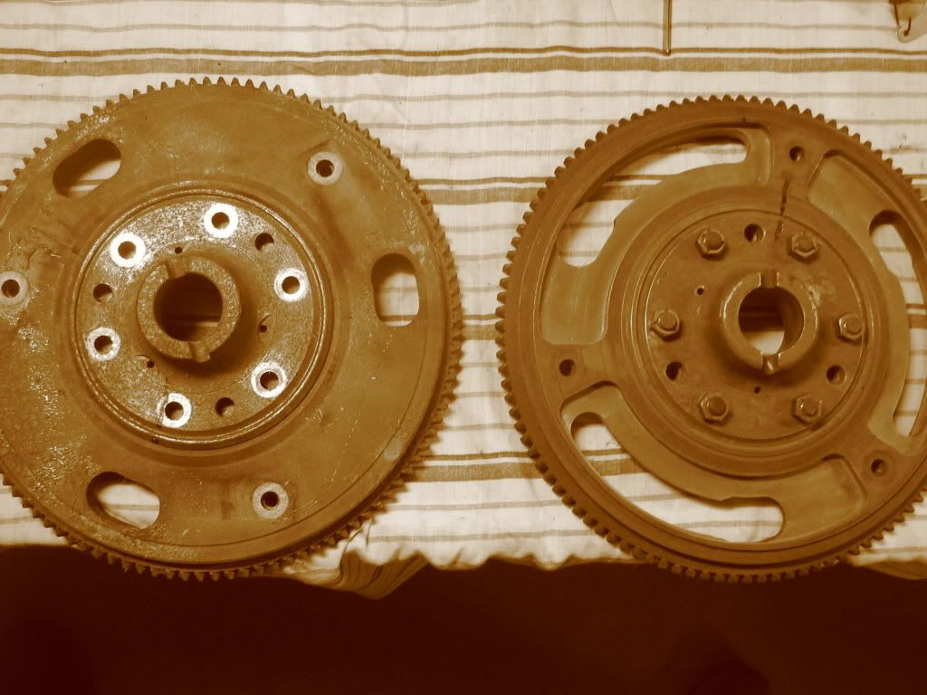

This is a miniman lightend 2 piece flywheel (pictured on the right). i weighted mine at 4.7kgs. much lighter than the origonal 1 piece i had in the car.
the standard 2 piece on is on the left in the below picture.

[edit] IMO that RH light one in the pic is too thin, for an iron flywheel. The stuff is brittle.
Another trap people fall for is welding the ring gear on if it comes loose. It's a great way to crack a cast iron flywheel.
[edit 2] yeah it all needs dynamic balancing before fitment.

Doc,,, there are literally Hundreds of these (my) lightened flywheels out there, did my first one when i was 16 years old,,, now 47,,, with usually 20 odd machined per year,,, that makes for lots & lots of them now ,,, Not heard of one breaking up (now i`ve hexed myself havn`t i??? ) BUT!!!!!!!!! they`re still retaining the factory thickness in the right spot(s) & no need for extra washers under the straps
they`re qll CNC machined exactly the same,,, if it were balanced before we lighten them then they are pretty well still in balance after we finish ( i always suggest balancing anyways)
They`re not "THIN"
I`m not a fan of just machining them thin,,, Just simply thinning them down tends to make them warp (not a matter of if,,, more a matter of when)

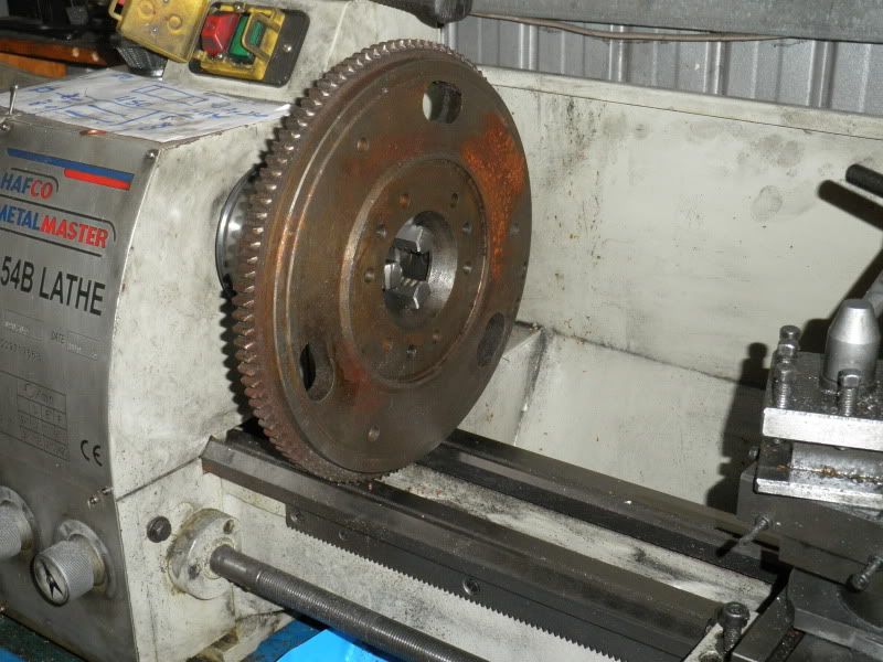

I use this.
it just fits. with about 2mm either side or the lathe ways. I normally use a 4 jaw and a dial indicator but this pics for illustrative purposes really.
I have mounted one on a rotary table and gotten fancy on the mill like madmatt does.
I have done a grand total of 2 so far. One has held up well and the other has sat on my self.
