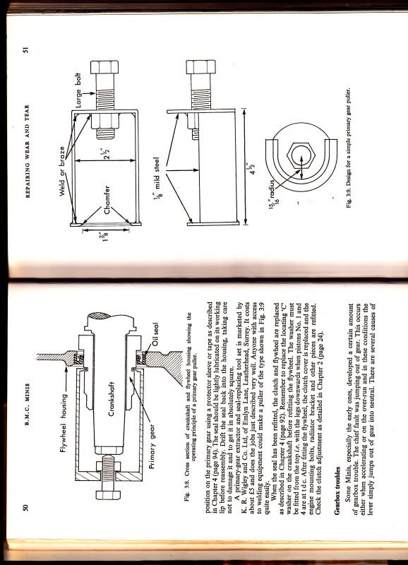

Easier way....
the BMC tool for it..... :lol:
Perhaps can make up something along these lines.....
(even works to remove primary gear when the bearing has spun :cry: )

MINImal effort wrote:
Easier way....
Yeap, made one years ago. Works a treat.
PostPosted: Sun Oct 03, 2010 9:46 pm
I can knock one of those tools up, no problem. thanks for the pics... :wink:

This should make things easier
Kiwiinwgtn
PostPosted: Mon Oct 04, 2010 7:41 pm
Thanks heaps kiwi, saves me the hassle of drawing one up. 8)
