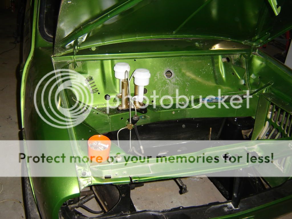

On a Mini K, what does the T union close to the Brake M/Cyl bolt too I seem to be missing a bracket.

The Brass 'T' is the 'splitter' between the front and rear brakes. It is very important to re-fit the bracket holding the 'T' piece so the steel lines don't crack (then no brakes).

So is there a bracket that it bolts on to. Is there another bracket that comes off the fixed bracket that the clutch hose goes through.

he T Piece bolts to a Bracket which is then held in place by the Clutch pipe.

Thanks. Seem to be missing that bracket. Have made one & all is good.Next question If the adjuster in the front backing plate is a little bit loose can you do anything with them or do you have to get another backing plate
