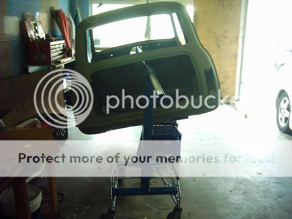

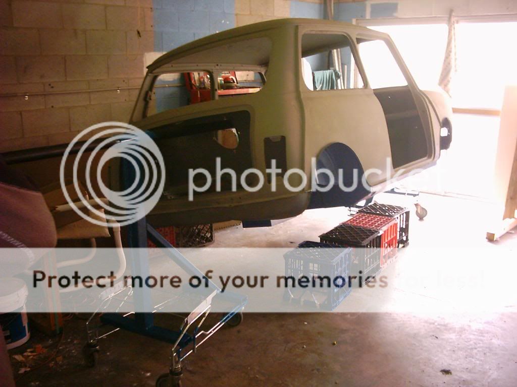

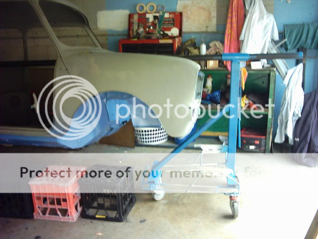

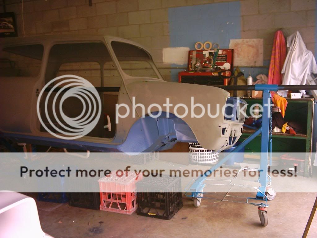

PostPosted: Sat Nov 13, 2010 8:37 pm
Posts: 2245
heres the set up I made wen I did my resto.. worked like a treat.. sold em years later and I've seen them around the state selling on ebay and at one stage was down in Sydney but I've heard rummours from the mini guys up here its back here again... I could make them again easy once you do it once.. the hardest part is nickin the trollies :lol:
Took me about a weekends worth of work with the welder and grinder..
Made it so much easier to work on the floor, as I just flipped the car around, and was great to move the whole thing around like a 2 yr kid and his push car :lol: oh and I also made it so that I could adjust how high I wanted the car off the ground with the easy of moving the upright in the box tube with a pin.. (look closely and you will see) in these pics the pin is out and the car on the lowest setting.. :)
