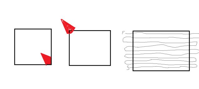

With Solid colours (this applies to acrylic only) you don't need to mask off sections after you're done. You can just move on.
As Mick said, I'd do the interior or underside first.
Remember the correct order too, edges and corners first, then fill in.. starting from bottom to top... (obviously section at a time)
<edit> once the inside, underside and roof are painted, try and hit the rest in one go...
<edit 2> I'll try and dig up my a pircture from my tafe notes that shows you how too tackle it...
<edit 3>
Found that picture I was talkin about... I'll try and scan it at work for you tomorrow.... This is basically what it shows you... but instead of a crude finger painting of a box, it has a whole car and all its panels, showing where to start and stop etc...
<edit 4>......................... nah just screwing with ya... was starting to look funny :P

Haha i love it!! :lol: :lol:
i'll print that out and take it to work tomorrow and give it to my apprentice. :D

Hey hey easy on that laughing your ass off stuff there Mr Frail :) Its not going to win any prizes but I think it gets the point across :lol:
DartzMan, I have to apologise, I didn't get a chance to scan the picture I was talking about... but I will do it as soon as I get the chance
Haha, I know... Its hard to explian technique stuff over a forum 8)
