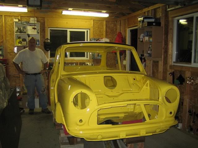

Posts: 460
Without the subframes, I have found it best to use wooden cribs (pieces of used 4"x4" posts) and 2"x6" lumber to span between the cribs.
2"x6" gives a jacking point fore and aft for repositioning cribs and support without stressing any of the Mini's floor areas.
My son even padded some 4"x4" with old carpet to protect the wee beasties when 2"x6" not used or to place on top of the 2"x6" to provide clearance to run lines, cable etc.
