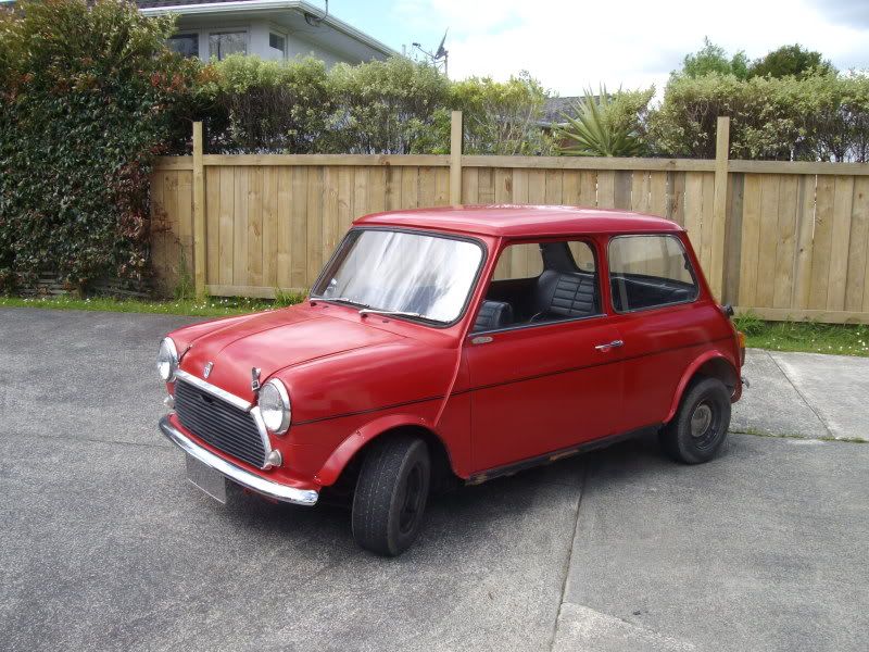

This thread is useless witout pics!
These are banded to about 5", they have aquajets on them still on the rear, and it handles like a dog! - they will not be used for road use again.
i'd be inclined to blame aquajets before any wheels for handling issues! :D
