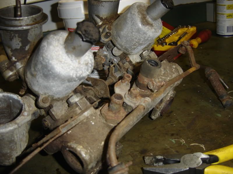

Hi all,
Soaked my disassembled SU's in Simple Green for a couple of days, and all old residue is gone. However, they are now a dull dark greyish color, i.e. like oxidized aluminum. Is there a product that will easily remove oxidation and brighten them up again?

I think you will have to just buff them for best results
Once you have done that there is a coating you can put on them.

It looks like the Simple Green has done the job in getting the Years of grime from your carb. I don't know a product that would take the tarnish off it other than a bit of elbow greece. Any of the popular metal polish will do the job just depends on the amount of time and effet you want to take. You can try anything from Brasso to Autosol to give the shine back. I would test them on the bottom of the carb first and see how much time it would take to get the result you want. You can go to the other extreme and and take many hours and take every scratch & mark out with various grads of wet & dry and buffing wheels
http://forum.caswellplating.com/
I also use POR Glisten I have used it on many parts and the motor in my Van is not painted a colour but brushed Glisten for that raw look

glass/plastic bead/soda blast?
before: http://i6.photobucket.com/albums/y223/A ... C03035.jpg
after: http://i6.photobucket.com/albums/y223/A ... C02318.jpg

Mick wrote:
Only problem you'll find with blasting Ally, is that it gets dirty very quickly afterwards. I personally don't mind the finish, I find it quiet attractive, but if ANYTHING even thinners touches it, you'll see a discolouration. In that regard its a bit of a pain in the arse.
As gaf said... elbow grease, no substitute for sweat.
PostPosted: Sat Feb 19, 2011 5:40 pm
I have been watching that on my set as I have been watching the weathering on the engine paint, zinc plated and bare surfaces since resto. I haven't found it to be a problem in the two years so far. I don't use mine as a daily however, but I think the the glass polishes more than it etches which stops oils from soaking into the metal.
