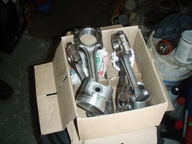

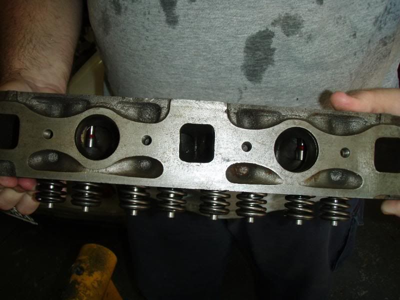

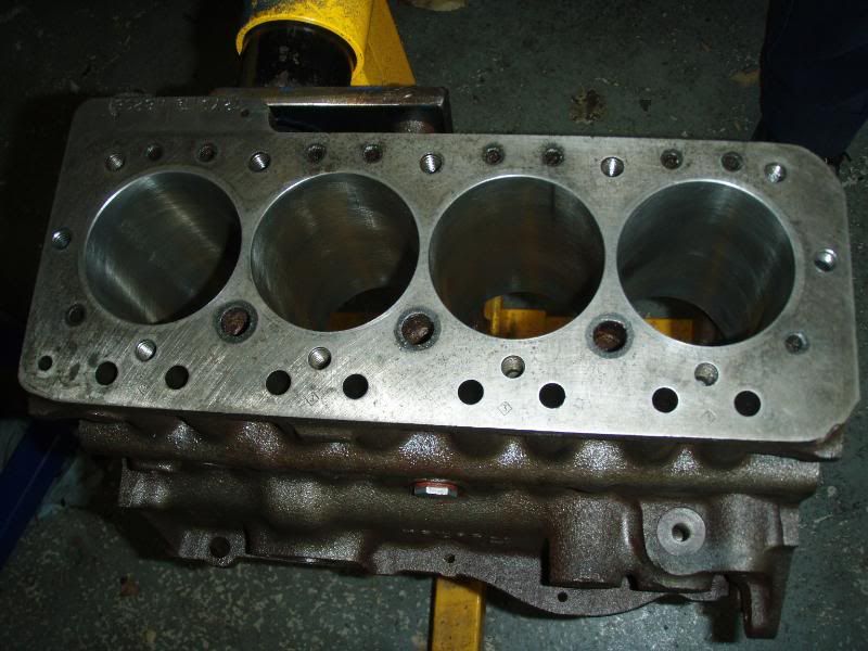

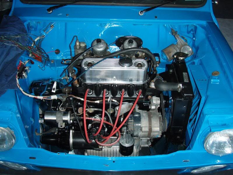

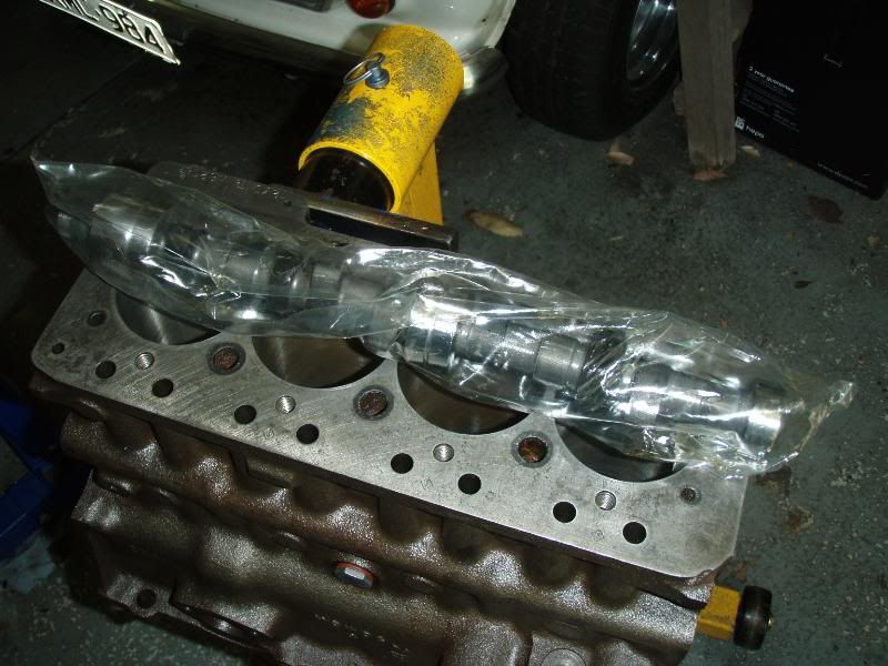

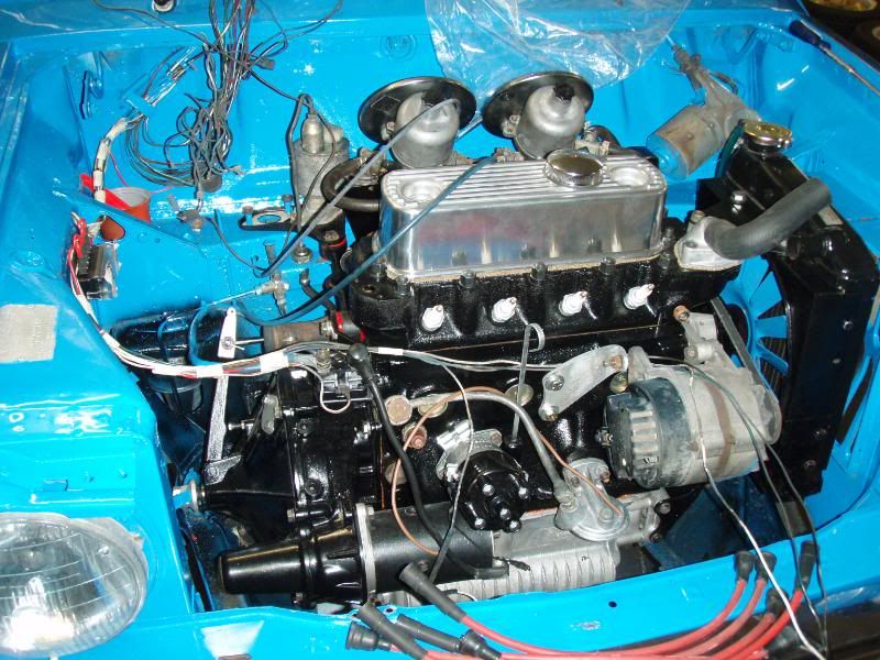

It's a new engine after running it for 10 mins at about 2000 rpm there was so much smoke so we took out the plugs and with a torch we could see about a tea spoon of oil on top of all 4 pistons could this be because a lack of breathers on the motor.Here are some pic's
Thats all the pic's i have of the motor before and after it's got a cooper s head the cam is a 295sc new pistons and rings .
A little more info
1275 +60thou (1330cc)
New Hypatec Pistons
New Cam Bearings
New Main Bearings
New Bigend Bearings
New Thrust Bearings
STD/STD A+ Crank
A+ Conrods (Light and Strong)
Cooper S Equivalent Camshaft
New Cam Followers
New Belt Drive Vernier Cam Kit
New High Capacity Water Pump
New Oil Pump
Fully Reconditioned Modified AEG163 Cooper S 'Big Valve' Head

You wouldn't get that much oil on each piston from 2stroke(d) petrol. I should know. I am guessing that you have an issue with your Valve guides on your head. Unless you have had a complete balls up with the machining of the bore to pistons. To me, I'd whip the head off and have a good look see.

Do the valve guides have stem seals on them?

you really shouldn't have done that. You've probably glazed the bores
People say to run in the cam at 2000rpm for 10 minutes, but that's only for a new cam in an old engine, you needed to run in the rings and bores.
Take it for a drive up a steep hill - make it work - low RPM, full throttle, you've gotta load it up to get the bores worn in
I would agree with Simon here. Don't run it until you can load it up, not for too long, just about 3 or 4 good hard bursts, up to about 3000 RPMs.

Does it have valve stem seals fitted? Often if there is no seals or the seals are buggered when you fill the engine with oil, the rocker cover fills up and oil can leak down the vale stems and into the chamber. Drive it around untill the smoke clears & turn it off and leave it for a while. If you get heaps of smoke on start up again its a fair chance you have valve stem/seal problems, If it continues to smoke all the time you have a problem with rings/hone/clearence issues. :wink:

I built a motor for dad, and a similar thing happened. It used to smoke at idle, just leave it idling for 30 seconds or so, and it'd start puffing away... he'd babied it when it was fresh and glazed the bores. After a while it went away
not saying that's definitely your issue, but I'd be giving it a good drive before pulling anything apart
I have that problem at the moment - I normally don't bother with exhaust guide seals, and left them off this time.... apparently I need them because I get a lovely plume on startup (but only on startup - just one big puff)

To me, it looked like more oil than would just bleed down the inlet guides. . .I wonder about the integrity of the oil rings. . .

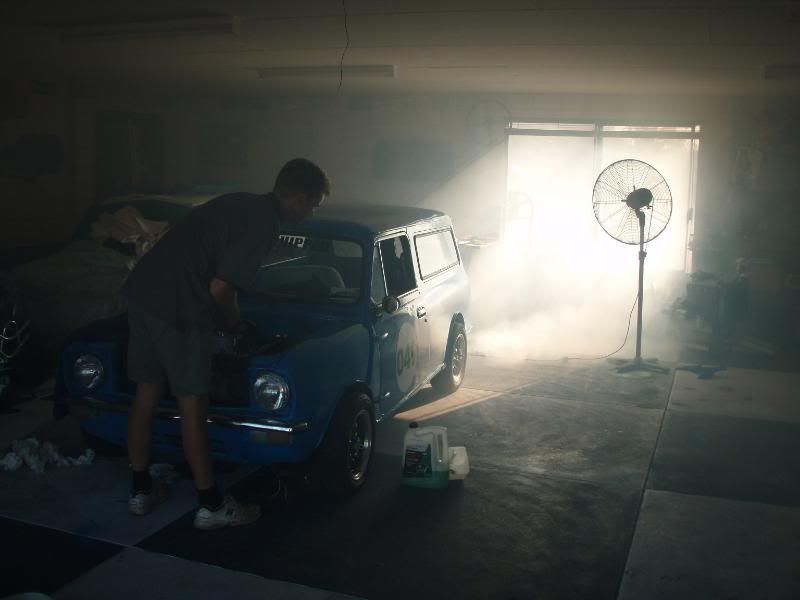

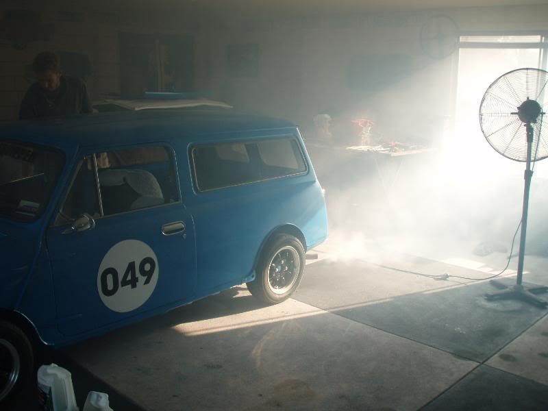

Gotta say that those smoky shed photos are tremendous!
PostPosted: Tue Mar 29, 2011 8:27 am
very artistic the way the sunlight is filtering through the smoke and blurring the nice little van :D
