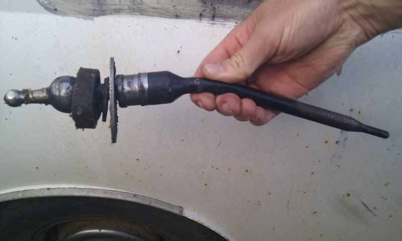

Now i have a part question, is this just your normal gear stick or is it quickshift one?

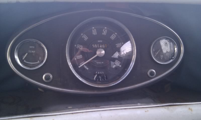

And is this the standard K guage setup

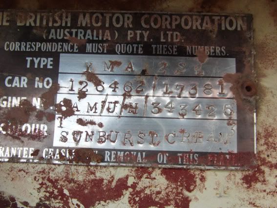

And finally, what year is my 850 body?
YMS2S1
126462 / 17381
8AM/U/H 343425
Sunburst Cream

YMA2S1
126462 / 17381
8AM/U/H 343425
Sunburst Cream
That ain't no Mini K, it's an 850..
PostPosted: Thu Feb 24, 2011 11:27 am
Erm, look at pictures, read words :P

sgc wrote:
Erm...
YMA2S1
126462 / 17381
8AM/U/H 343425
Sunburst Cream
It sure is, i have the K, an 850, a matic and a clubbie too
just curious about the year that it is

I'd say the 850 is a '62. Possibly the first half of the year?
Saxon Green 850: http://www.ausmini.com/forums/viewtopic.php?t=62641
Nightfire Red 850: http://www.ausmini.com/forums/viewtopic.php?t=66555
