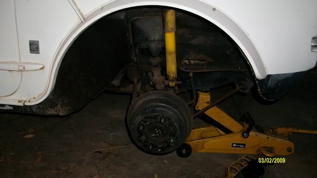

hey guys. Im pretty new to the mini scene and i have just purchased a 1275 with drums :(
So it goes without saying i need some front disks.
I have tried to do a search for what options i have and its very confusing. Basically I am hoping to find something that will bolt on without any hassles, and at minimal cost (hopefully there are some for sale on here?!)
I was browsing through ebay UK and found some, not sure how much postage would be or if they would even suit my car?
http://cgi.ebay.co.uk/ws/eBayISAPI.dll? ... K:MEWAX:IT
Anyways here's a picture of my drums, if that helps!
Ryan

It depends..... what size of rims you are running, or intend to use.

If you run 7.5" Discs you can go to 10" wheels in the future. If you don't plan on going to 10" wheels then go to 8.4" discs.
You will need a few more parts than what is shown in that ebay link. Check out the following two links:
http://www.minispares.com/Product.aspx?ty=pb&pid=37121&title=
http://www.minispares.com/Product.aspx?ty=pb&pid=42540&title=

General rule of thumb is fit the biggest discs that will fit inside your rims;-
10"wheels = 7.5" (Cooper S) Discs
12" (or 13") wheels = 8.4" Discs
Don't forget you will need to change the rear wheel cylinders to those with a 5/8" bore to maintain brake balance between front & rear (unless you like swapping ends).

thanks guys. So you can't just fit them over your existing hubs like the guy says in the ebay ad?
And you need to change drive shafts as well?

Yes should be straight swap but it depends on the dish of the wheels you currently have.
No, driveshafts should fit straight into disc brake CVs.
My advice having been through this whole drama, buy brand new brakes. Give second hand kits a miss, they are a minefield. For a few extra $100 you get brand new everything.

The ebay ad is refering to using existing disc hubs. Which you do not have.
Drive shafts are the same but the cv joints are different.
My advice buy new around $1000 save alot of hassels.
