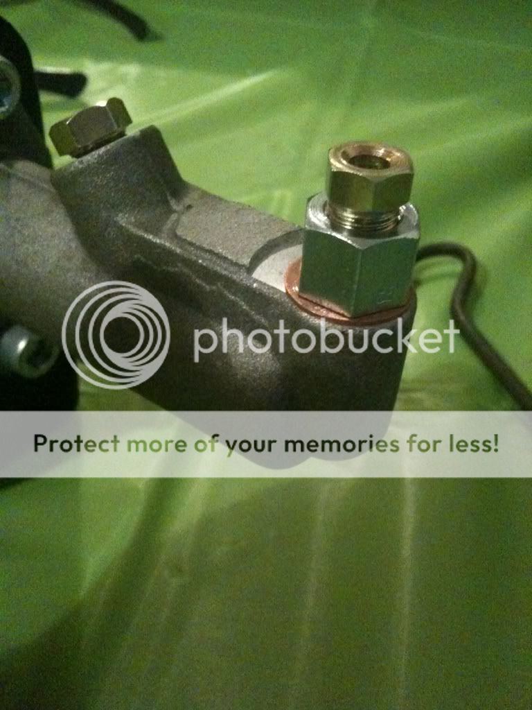

Could someone explain sizes and types of brake line fittings please. I've tried to piece it together from searches, but i'm still confused.
I'm putting a hydaulic hand brake in, and today went past 3 brake specialists with old brake lines, mentioned about 'tapered threads', and got confused looks from them (had to get a fitting to reduce down to 3/16 tube for the master cyl I have here, which apparently is uncommon).
I ended up with the fittings I needed for the master cyl, and a few more tube nuts, which are the 'straight' variety. If they are useless for what I need to do on the 74 Clubman, i'll use them in the Moke which will have a Rover master cyl and brakes.

Ok this is the confusion I had gathered from searching! Not an issue now. Just gotta be careful when I do the Moke.
