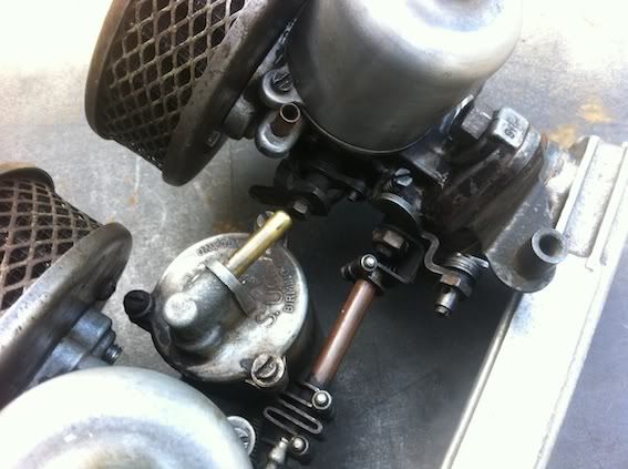

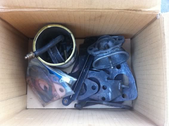

OK, below are a few more pics of the linkage as requested, I pulled these apart about
10 years ago and not 100% sure if I put them back the same way, I also have a few extra linkages and brackets could be off the twins or other single carbs??
