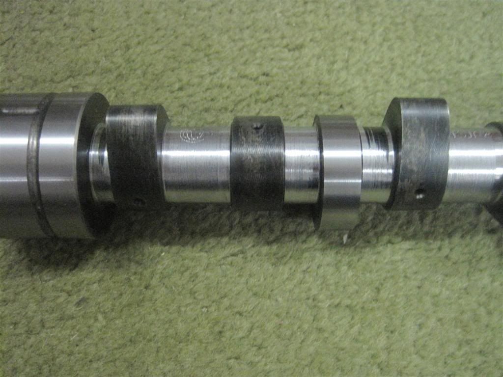

Also the billet cams that i use now have the lobes force fed with oil to get oil between the follower and the lobe. The holes are drilled on the opening ramp.
