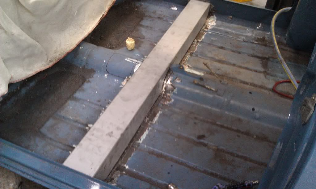

Just measure it up andget a sheet metal place to fold one up for you. It'll be cheaper.
It only cost me $80+gst to get my floor cross memper folded up in 3mm ( or 4 i can't remember) zinkalume .
