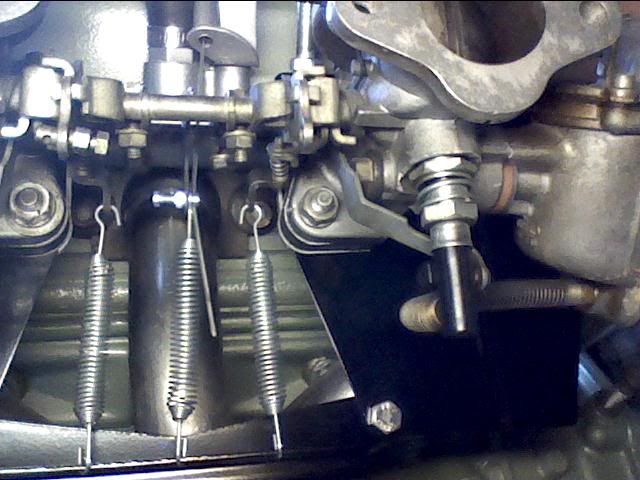

Hi, trying to work out if i have put this together right?
im not sure where the centre spring goes, atm i have it connected to the accelerator clamp
and if the linkages are the right way
sorry pics aren't the best laptop camera
1971 mk2 police cooper s
1988 rover mayfair modified!!

There is normally a little tag that the spring attaches to.
The tag sits where you have the spring. I will see if I can find a photo or something...

but the accelerator clamp still goes through that hole? and the tag attaches to the clamp?

Actually you have the wrong cable bolt. Yours is a choke cable one not a throttle one.
This is the correct one and it shows the spring link (AUD3152)
It goes in the same place and it has a split pin in the end of it.

thanks morris 1100,
ill have a look in the spare parts bin
