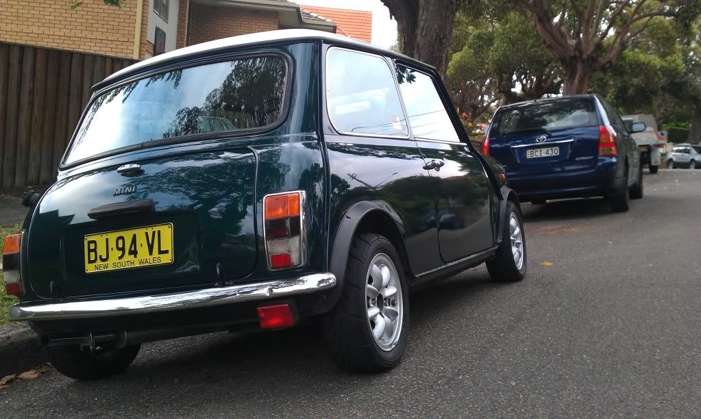

hey,
i currently have Yokohama A048R's - 165/55 R12. i was wondering if there was a optimal tyre pressure to run in the rear tyres. Currently i have 19 PSI in the rear and they still seem quite firm. There is no weight over the back, i don't take people in the rear seat, i don't carry a spare tyre/jack around town, i have a small light weight battery. Is is absurd to run any lower?
Thanks,
Bill
PostPosted: Mon Nov 07, 2011 7:26 pm
Posts: 6858
Not sure about 12" wheels but I run 28psi at the front and 26psi at the back, slightly more if going for a high speed freeway run. 19 sounds way too low to me...

PostPosted: Mon Nov 07, 2011 7:30 pm
Posts: 544
well take a look at this, these are both at 19 PSI, they don't even pillow at the bottom!? Magic.
Bill
PostPosted: Mon Nov 07, 2011 8:35 pm
Posts: 2611
Location: werribee vic
32 psi front and 28 psi back is what I recommend , two recommended factory pressures for 3.5x10 and 4.5x10 were 26 front 24 rear and 28 front and 26 rear , I tried on my Mini S the latter but have moved up to 32 front and 28 back and I,m not going to change anytime soon
PostPosted: Mon Nov 07, 2011 9:54 pm
Posts: 6858
Just cause they look right don't make them right. It's because they have strong sidewalls to prevent rolling over in heavy cornering. I suggest you pump them to at least 25psi
