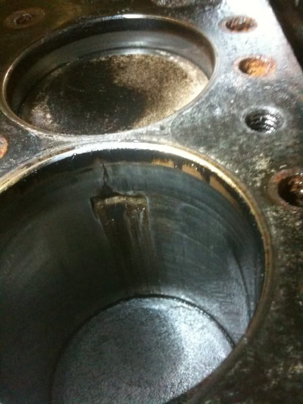

its the #4 Cyl
on number 4 cyl :cry:
not sure if i can save this block as the pistons currently in it are A2/71 040
(40 thou overbored yeah?)
next question is what happened to cause this?
my guess that the gudgeon pin has moved is this a common fail?
Doc you on air???

Could be saved with a massive overbore and rare pistons, or sleeving.
But it would be much more economical to get a new block. I have one here if you cant find one locally.

As Kirby says, a big overbore or more probably resleeve it.
On a Cooper S block you might bother saving it, but anything else I would just grab another block off the pile and use that.

Looks like a small bore by the spacing between 2 and 3.. I'd bin it and find another.

If it's a small bore, find another, they're a dime a dozen, or free.
Big bore, i'd look into boring and sleeving costs, and weigh it up against a new big bore block

Salvagable - yes by sleaving, but probably not worth it. Might need to make some phone calls.
Cause - usually from the last guy fitting the pistons to the Rods putting the circlips for the gudeon pins in the wrong way around and / or dirty assembly. I also use loctite on them.
Common - yeap, quite common.
Get some Ozzy 998 rods - they were a press fit pin and will directly interchange with the floating type.

Thats what mine will lokk like when pulled apart (or breaks) the circlip holding the gudgeon pin in is gone and the gudgeon pin runs up against the bore :shock:

typical problem.. one of my 1100's did this years ago.. lasted 10yrs on the build until it did it..
As others have said, yes most likely fixable, but most likely not worth it for the price you can get another block.
I have a 1098 block here if you can't find one down there..

I've had quite a few small bore motors re-sleaved. You don't need to do all the cylinders, and it wasn't that expensive either. It's not uncomon to find blocks that were sleaved from the factory..
