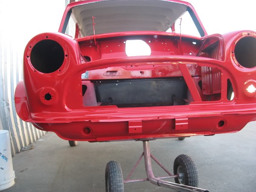

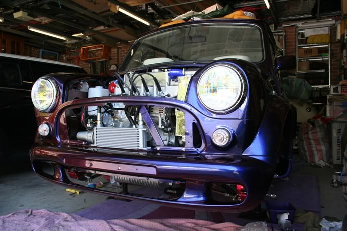

You can buy the angle brace from Minisport or Minispares UK, which I did and then fitted to my recent project. I temporarily fitted my oil cooler to work out where to fit the brace as it just misses the right hand side of the cooler, when looking from the front.
I have found the latest front aprons being supplied really need this brace as the metal is so thin but on my S which was restored in 1992/3 the metal must have been thicker as I have no brace on it.
