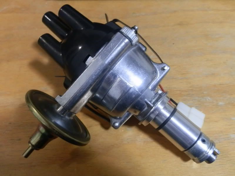

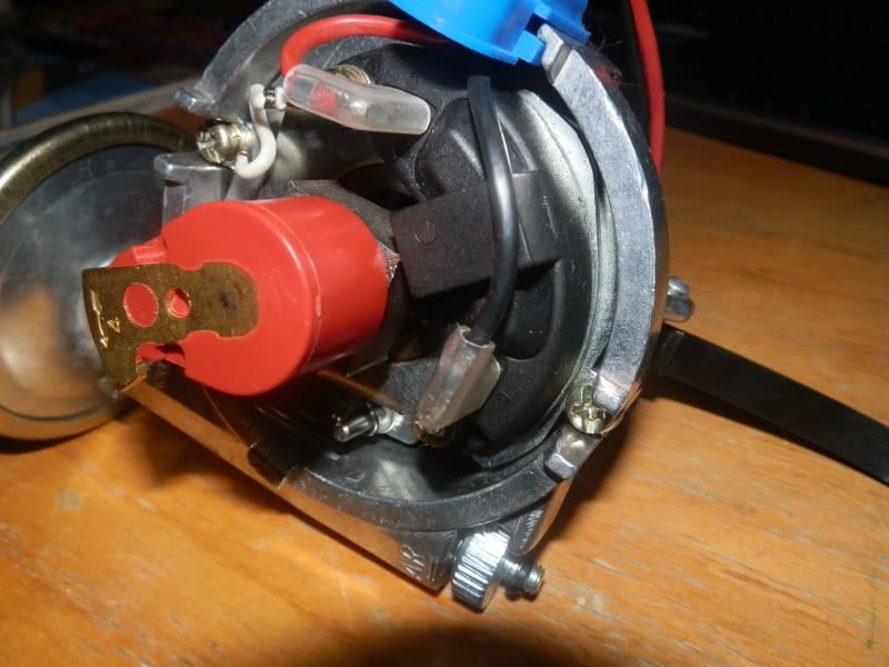

I picked another distributor up last week, and for the price I am unsure why we need to trawl through wreckers for Pulsar dizzies anymore...
This one cost me 118 dollars delivered, is rated for (in fact they require) sub-1.4 Ohm high output (electronic ignition) coils. It's curved to any particular ignition curve you care to specify as it is packed up and mailed. The best part is that it is also brand new...
The module is different to previous modules, and uses an interrupter blade rotating on the shaft. Both the hall effect sensor and the usual magnet is stationary within the module. Got to be careful when you order however, some are rated for standard coils, while others are high energy rated. There's a ten dollar difference between them.
