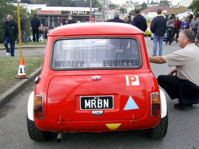

PostPosted: Tue Jul 24, 2012 6:47 pm
Yeah, with no weight on them the rim is the widest part, but only just:
Looks different once loaded up with my weight :roll:
