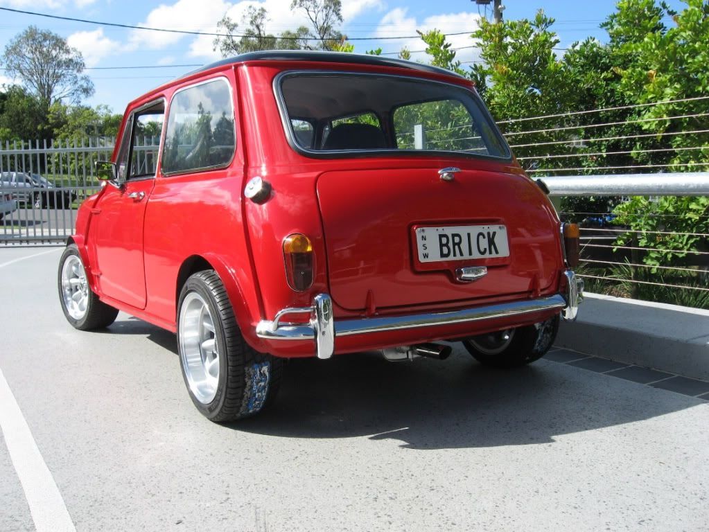

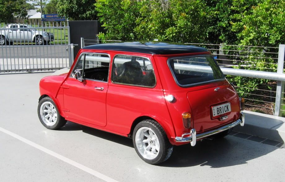

i ran 13 x 7 deep dish on rears with narrow drums and 13x6 on front with dicsc, had to trim 20 from the front of the arch up 150mm , 175 s all round rubber
i have 2 x 13 x 7 deep dish rims only for sale brand new

Thanks dodge, nice pics
So even with 13x6 you had to cut 20mm off the front guard (if I understand correctly for about 150 mm high)?
You photo doesn't show the front wheeles but how did you manage the symmetry of the arch? Is it obvious that the arch is now a little oblong (I guess$) or is it not noticeable?
That is my concern regarding having to cut the arch....
