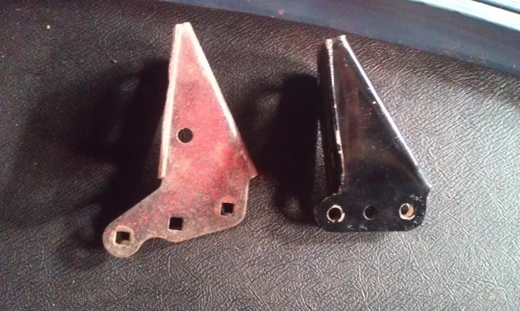

I have two different types of seat brackets and I was wondering what models they were off.
I want to modify one set, but I want to make sure they aren't rare or anything.
My guess is that the longer ones are the stock 850 ones , and the other are later model ones...
Correct??
Image[/img]

Stock Oz made 850 seat brackets only had 1 hole and were rivetted onto the seat, they had no bolts & wingnuts.
My `guess' is the RH one in pic is Morris Cooper up to 1964, and the LH one is later.

The red one on the LHS was used on the later models.
I cannot comment on the black one - foreign to me, and knowing Kevin's prowess I'd run with his comment until proven otherwise. Or maybe use the parts book?
..still waiting for the Italian Job sequel to see if the bus went down :-) :-)
PostPosted: Mon Aug 06, 2012 11:42 pm
Black on is bog stocko rover, used early 80s right through to end of production.
Red is aussie and early car up to 77.

Yep I agree with Harley.

Ive got the left one in my 77...
Never seen the right one.
