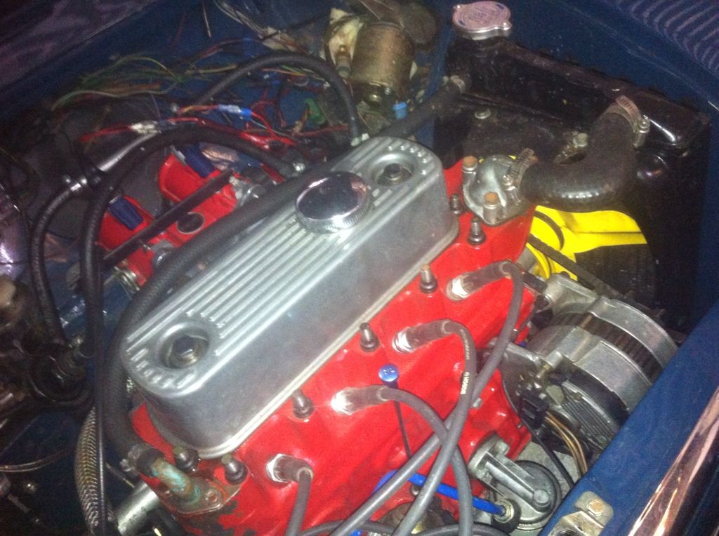

ok so i have found my weakness ..
i can't for the life of me tell if my fan is on the wright way ..
i thought it was fine buyt now after looking at the Cooper on the shannons auction im all confused.. would this explain why the Fan is so noisy ?

The reason its noisy is because its a 4 blade fan.

I think the four blade fans will only go on one way?
And yes they are very noisy.

Yes, the 4 blade can only go in one way.

Cheers Guys i was pretty sure that it was correct...
but i thought i best just to check ..
would a six blade fan be better for air movement ?
just trying to chase a heating issue,
