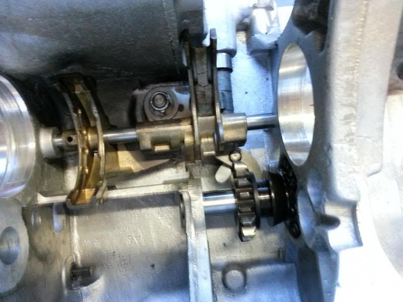

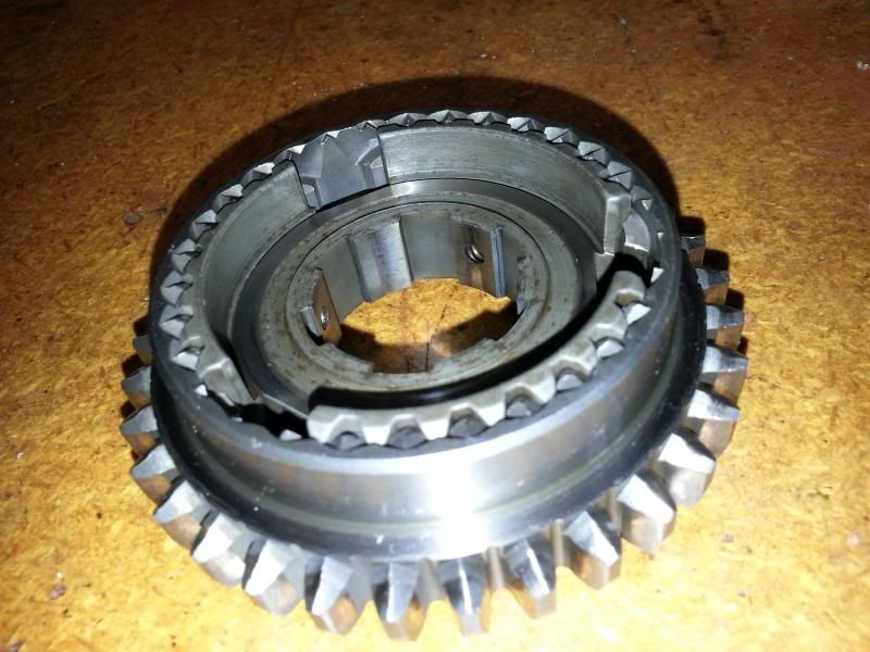

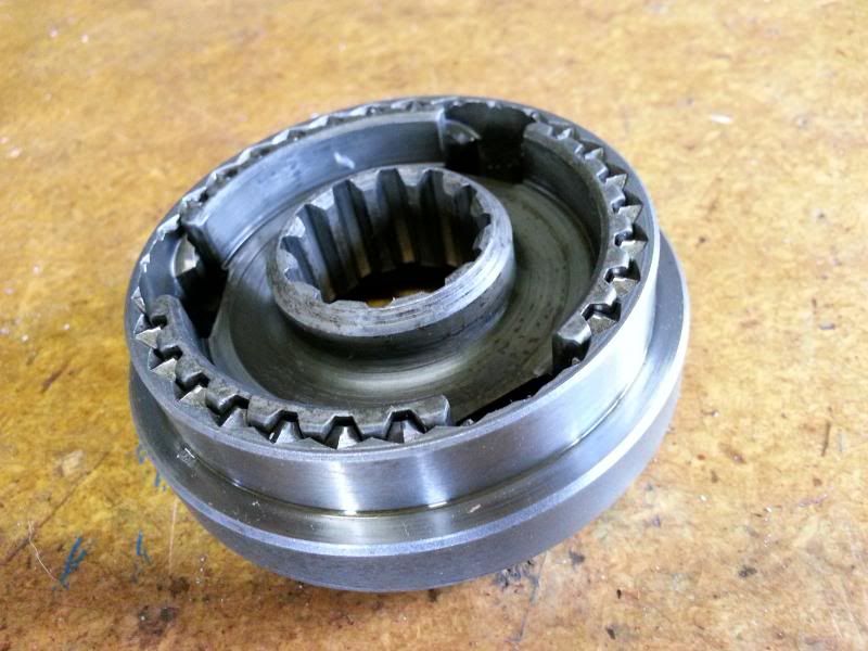

Folks,
Wondering if I've got the inner and outer syncro hubs oriented properly?
Also do the s'lector forks and reverse gear appear to be assembled correctly?
(Should've taken more disassembly photos!).
Thanks.

The 1st/2nd synchro hub (top photo) is wrong, the inner is wrong way round. 3rd/4th hub is correct and the selector forks also look correct, tho I haven't done a rod change for a while.
Way to remember the orientation of the synchro hubs is that the long side of the inner goes with the long side of the outer (where the selector forks run). Can see this for the 3rd/4th hub (second photo).

Matt, I've just rebuilt my pre A+ rod box about 2 weeks ago, took me ages to figure out 1st/2nd inner outer. I eventually called Matt Read "TheMiniMan"!
Justminis sums it up....as TheMiniMan told me!
It's the same for the 1st/2nd as 3rd/4th, only the long side of the inner on 1st/2nd is not as obvious as 3rd/4th.
Cheers Shane
