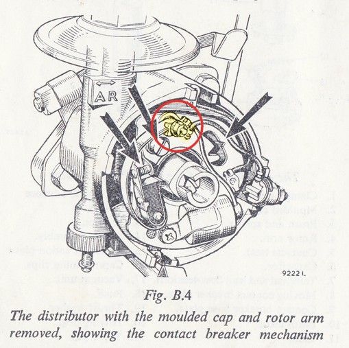

so literally a mile or so from home, but luckily on my street, the dreaded lose all power and come to a stop (3 mins earlier I was in the middle lane on the F6 doing 90ks!)
I took a wild guess to what it was as it had done something similar before years ago and yep, the low tension wire from the coil inside the dizzy had come away from the small nut on the points.
I go to try and unscrew it to get it back on and the thread inside the screw snaps off with the nut still attached, and then the plastic plug behind that splits in two as well!!
My question is, do I get a whole new distributor or is this part replaceable? and or worth replacing??
the nut highlighted here is what came off
Luckily the NRMA man was there in 10 minutes, attached an electric ignition bypass or something and got me started to go the last bit up the hill home.
thaks in advance for any of your help once again
Steve

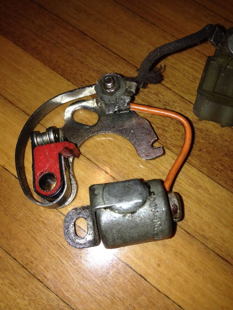

I'm pretty sure the part you are talking about is part of the points, which are replaceable anyway. They are normally replaced when worn anyway.
This is the points set and condenser I removed to do my replacement.
The electronic replacement will look sorting like this.

yep pretty much - but do I still need that nut and screw to be attached as mine snapped right off!

No, not if it's part of the points. Normally when you replace the points and condenser everything in my first photo goes in the trash.
Steve it's easy. The points are removed by undoing the big slotted screw in your pic at the middle arrow. You would also undo the small phillips screw to remove the condenser. Just be careful not to drop the screw into the dissy.
It all just lifts out. You could then just replace with a new points set and condenser, set the gap of the points to the correct opening and you are back in business as before.
If you decide to fit the electronic kit the plate is the same shape and just bolts in the same way, theres no condenser anymore but there now two new wires that go to the coil.
There is also a circular tigger that you slip down over the shaft under the rotor button.
