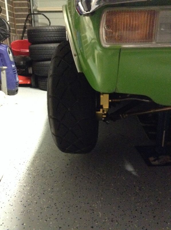

Ok got a little problem and l think l know the answer but l would like some advice regardless. This afternoon l installed a 7.9inch 4 pot minisport drive assemblies. But now I've got this problem, steering wheel is at dead centre, my wheels are now opposing each other 11 o'clock and 1 o'clock.
Now what l don't understand is why this has happened. Is it because I've gone from solids to vented discs, or because my hubs are now from a 8.4 inch setup or have l done something stupid? Can l wind out the the tie rod to correct this? Then get to a tyre shop for a alignment. Thanks!

PostPosted: Mon Feb 10, 2014 2:07 pm
Posts: 1500
Location: perth WA
Put it on the ground and see what happens.

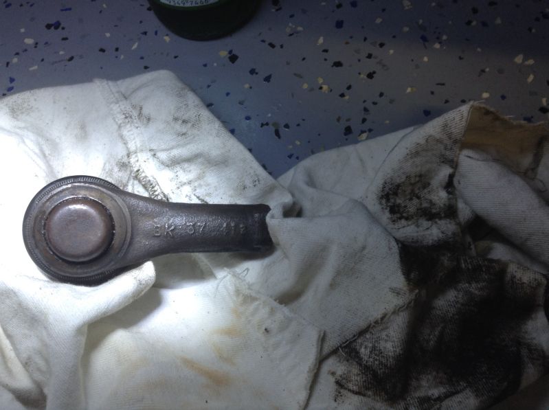

That is why I enquired about the Part Number
John on the end of the tie rod it is stamped bk 37 41 2

 Post subject: Re: Steering question
PostPosted: Mon Feb 10, 2014 3:22 pm
Posts: 780
Location: Quakers Hill
Yer done that no good!
PostPosted: Mon Feb 10, 2014 3:26 pm
Posts: 6750
It's the steering arm part numbers he needs to know. There were different lengths for different applications.
