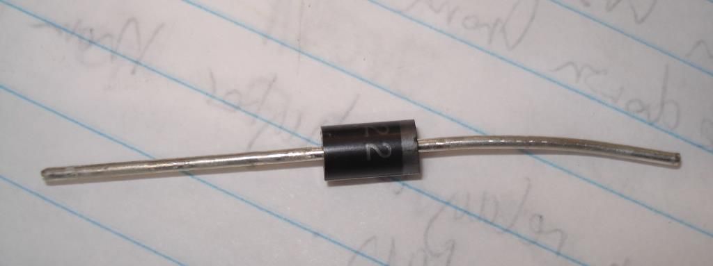

I took a punt and stopped off at Jaycar after work to pickup this;
It's a "Schottky Barrier Rectifier (40V 3A) 1N5822" which allows current to flow in one direction only (from left to right as pictured).

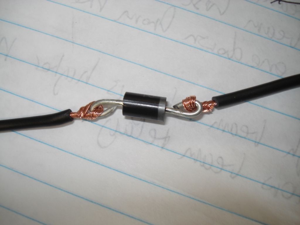

Following the lead of the author of the article I placed a link to (thanks Allan Brown), here's what I did with it;
Formed a loop each side and attached some wire on each end;

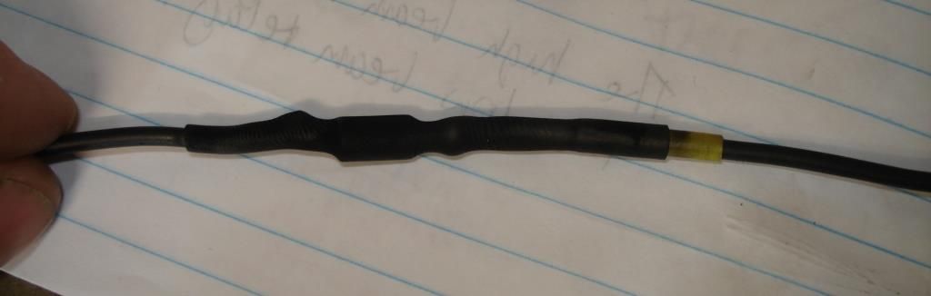

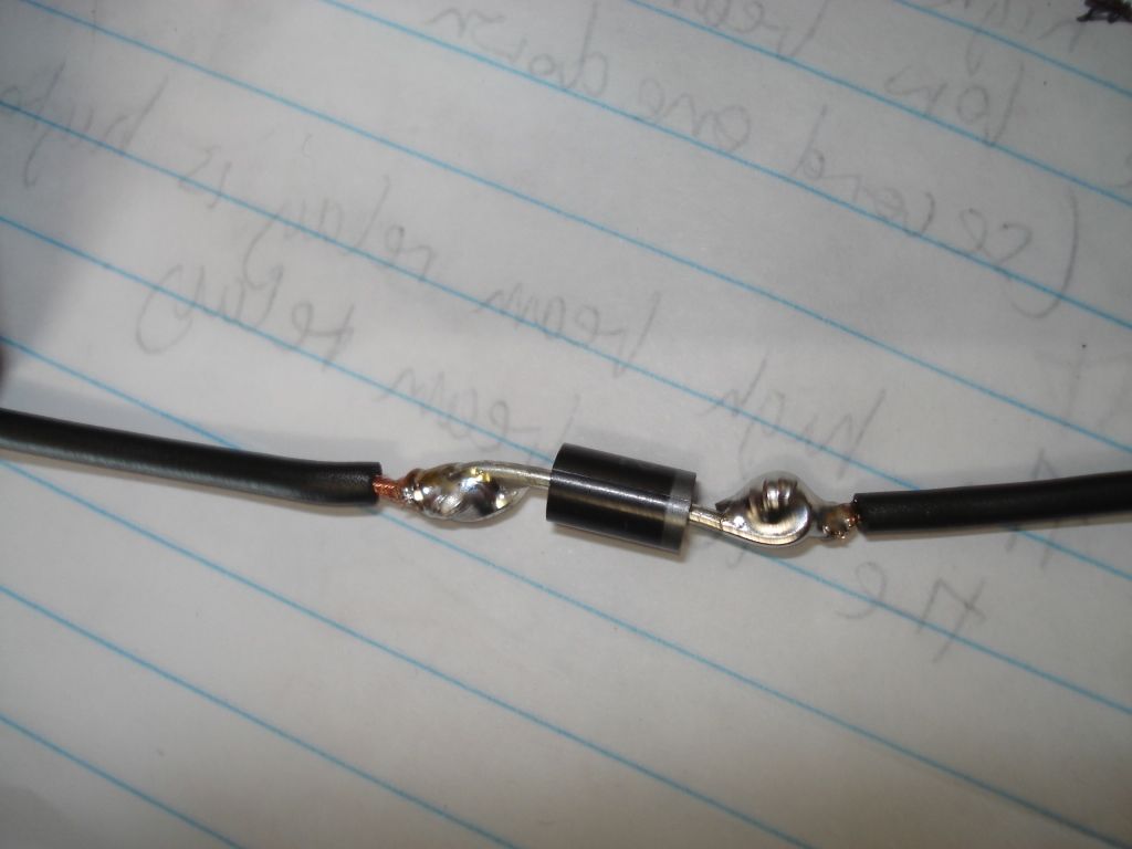

Soldered it up, marked the banded end (the one that needs to be closest to the alternator) with some yellow PVC tape and then shrink wrapped it;
Soldered it inline with the brown/yellow wire that goes to the small -ve (IND) terminal on the alternator and shrink wrapped the lot.
Plugged it in and fired up the beast and it now turns off with the ignition key.
