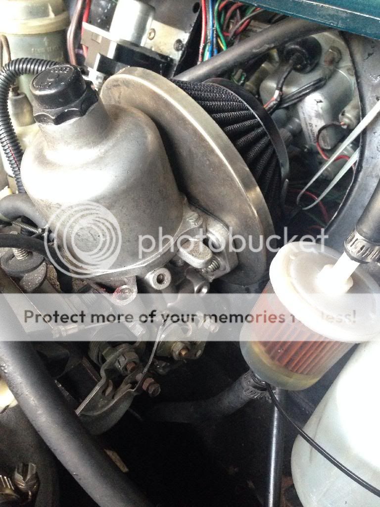

Hey Nathan, I have pretty much the same set up...not much dramas, the k&n air filter does sit in the firewall hole but it's just clear of the back of the speedo (the speedo cable does occasionally get wedged in but I'm getting an angle drive for the cable soon) I'll post pics when I get home for you

Had a look at mine and there is a little more room, not sure if this image link will work...
