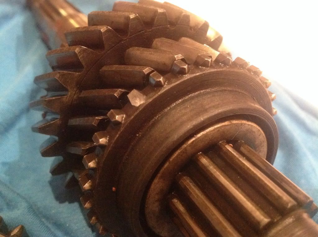

After finally pulling my gearbox apart I have removed most of the gears and bearings from the motion shaft. On inspection most of the cogs look good, no damage, no pitting except two!
The first one I think is part of third gear! One tooth has snapped! Plus I can't get the pegs or plunger things in to remove the thrust washer! Any suggestions?

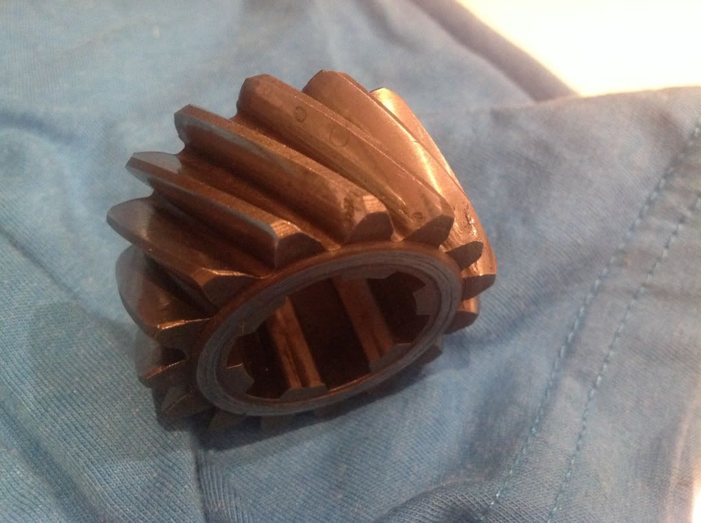

Secondly the Final drive pinion has three teeth in a row damaged! Where's the best place to find replacements of these two parts?

To be honest , if the rest of that 3rd gear is like all the other teeth, & only that one dog has chipped off
then i`d re-use it, shouldn`t be an issue at all
the pinion doesn`t look too bad either really, but i can`t really see the whole thing so it`s a bit hard to tell,,, ive seen way way way worse in a mini & still going ok

Pinion damage is often caused by people when using a cold chisel to flatten the locktab. You need to be careful to keep pressure off the teeth, they are brittle.
I's use the 3rd gear but find another pinion, and a crownwheel too if it's marked.

With Regards to the pinion, The crown wheel is not as wide as the pinion
You should be able to see where the two have meshed, if the damage is
outside of this area, then I would suggest You can use it without problems.
In my opinion when ever a gearbox is rebuilt care should be taken to mesh
the crown wheel and the pinion back the way they have been running before,
Some people may disagree with this,
Looks like I'll need to find a new pinion I suspect you are correct, I think it could have been my Neanderthalic removal that caused the damage! The crown wheel is fine.
