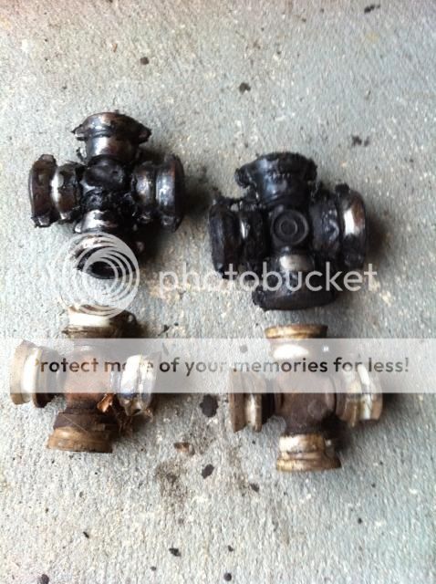

I've just swapped over to a set of the needle bearing ones. The part number above (GUJ102) from Karcraft are $17 each for good brand ones (GKN). Mine had slightly different u-bolts for each set though, one were a bit thicker and the other a bit thinner, and fit the plastic cups better.
New inners on the left, old ones in the middle and rubber ones on the right:
